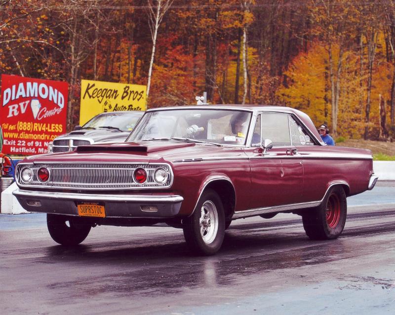

Howdy fellow mopar guys, I`m putting together a 65 coronet street strip car and wanted to pick your brains on what is the biggest tire / wheel combo I can put on the back of this car. I read some of the post regarding this and a fella called Super Stock said he runs 15x10s with 6.5" back spacing with 28x10.5 MTs on his with stock spring location and no mods to the wheel well. Can someone verify that for me. My car is all stock at this point and I dont want to cut or modify this car at all. Any feedback would be greatly appricated... Any photos of your set ups would be a big help too if it aint to much trouble...

5.7 hemi is right on. When my '65 was completely stock as far as suspension, I was able to run 275-60X15 tires on 7" wide wheels with a 4 1/8" backspace. I used the same measurement wheels to run 9X29.5X15 M/T slicks at the track.

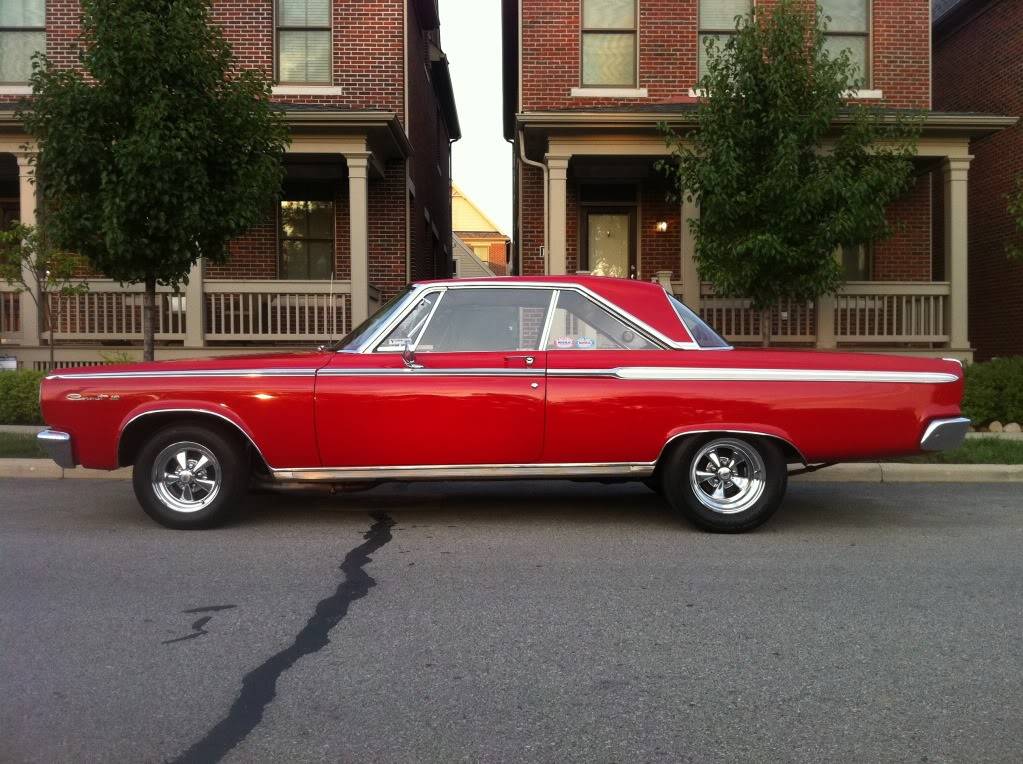

Not true. I had a 10" Cragar on mine and they fit with about 1/2" on each side of the sidewall.
Now I'm running 8" WheelVintiques with 3.25" back spacing. Superstock springs in the stock location. I have about 5/8" on both sides of the tire now.
Tires: M&H Racemasters 275/60/15
http://www.mandhtires.com/M-H-Racemaster-Street-and-Strip-Drag-Slicks/P275-60-15#.T8l4392yyi0

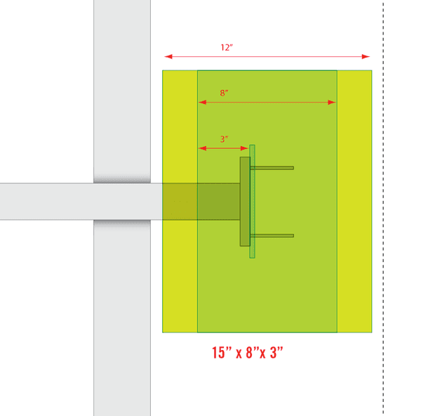

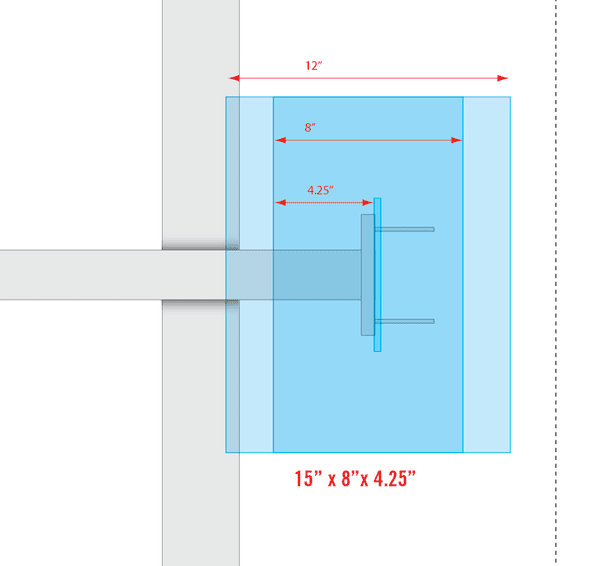

Here are the scaled computer renderings I drew to figure out what size rim I needed. In the drawing you can see the axle, leaf springs, and inside of the fender.
I actually fit the tire to the rim and measured in the first 2 drawings. Once I had those measurements I was able to figure out the right proportions for the 3rd and final drawing. You can see how the sidewall proportions changed on different size rims.
This set-up barely rubbed on the leaf spring.
This set-up wasn't even close.
This drawing shows a 3" backspace, but I ordered a 3.25" strictly just to make sure it fit centered (because I could've used a spacer if necessary). This looks and fits perfect on the car.
Lemme know if you have any questions.

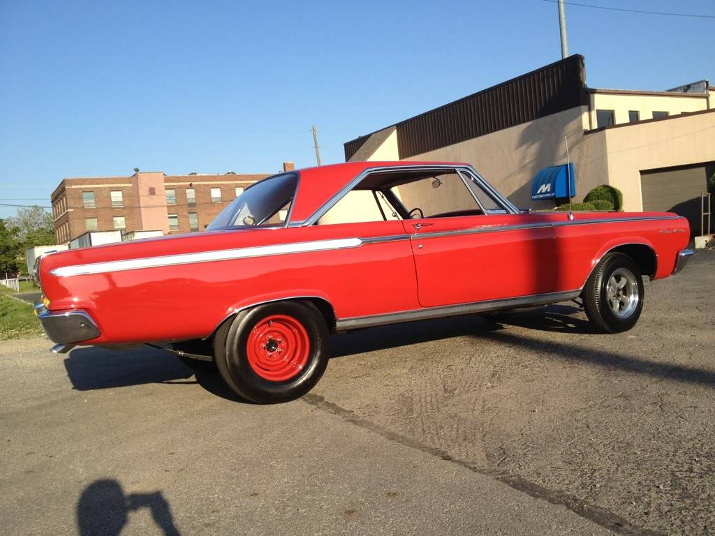

S/S springs in stock location.
I used a 15x8 steel rim with 4.5 inch backspace.
For tires I have 295/65/R15- M/T Et Streets.
It's tight but works............

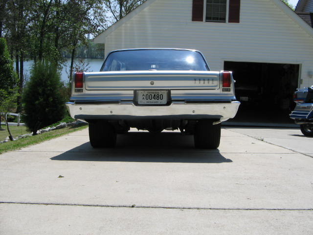

I had a set of 10.50X15X30 slicks on centered wheels with stock springs and perches on my '65 Satellite. This was inside the stock fender wells too. Looked nice and really worked..............
