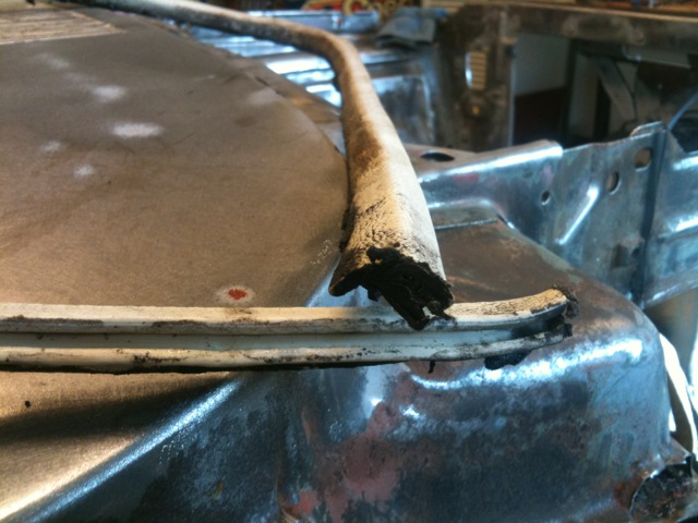

Took a picture of it, it is made of rubber with a steel core, than I think it is covered by the rear window trim, any more ideas?
Is it fairly flexable?.....reason being, it looks a bit like pinch weld, similar to what you'd find in the door jamb area.
A bit hard to tell from the photo, but if it's the same type of product....you can buy it in lengths and various colors....just asking:edgy:

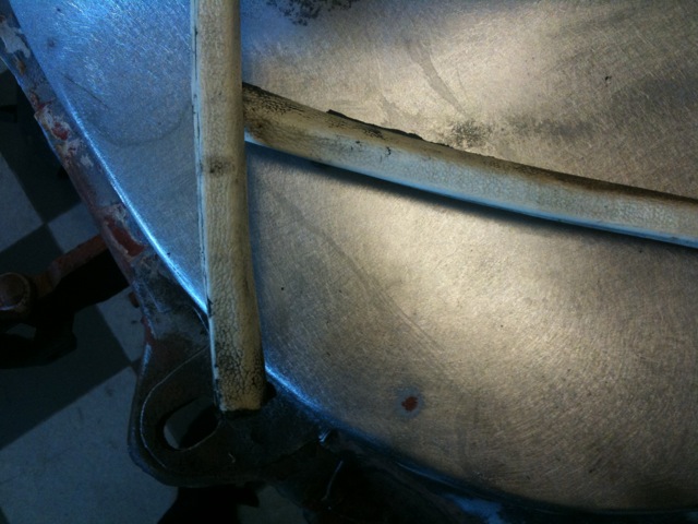

It looks and attach like a pinch weld (thanks for teaching me a new word!) but it has an extra "lip" that seals against the rear glass, and it also has a pattern that looks different from a standard pinch weld, will go out in the garage and check the inside rear window trim and if it cover it I can use it as it is. And it was not me that took it apart from the begining, it came that way when I bought it ;-)

It's rear window molding and you can get it from Legendary. There is no metal trim on 68-70 2 door b bodies. That plastic molding pushes on to the headliner barb that screws to the roof structure and partly over the pinch welds.
Heres a pic of the barbs.
Heres the link to Legendary. There are 3 and 4 piece sets, My 68 and 69 have the 3, but if you have the org trim from your car just order the same. These sets are for the sides and upper areas of the window. The lower trim attaches to the package tray and needs to be ordered separate if needed.
