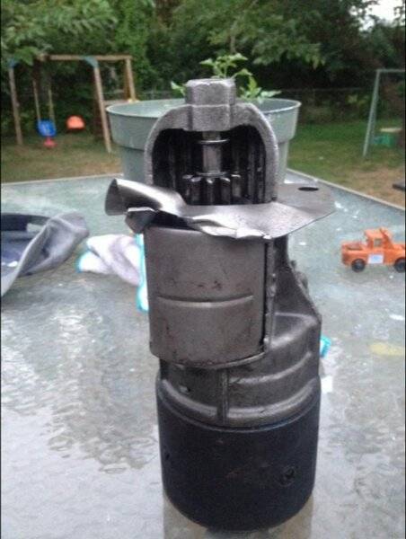

Here's a guy who had a loose tq bolt and it grabbed the starter dust shield.
https://moparforums.com/forums/f62/75-6-225-starter-shim-flexplate-17623/#post121943
