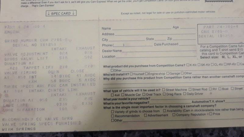

What Octane Level should I need for 10.5 to 1 Compression?
What is your cranking cylinder pressure?
Been a while since I ckd it. But Im thinking was in the 210-215 range
Its been almost 4 years since I ckd it. But I remember they were all over 200 for sure
My cam card is attached. Its real mild , car will idle at 900 with no issues
Its a solid flat tappet setup.
Just went thru the valves a few months ago.
The engine was built over 20 years ago now. And for pistons it had/has the old MP 12.5s in it. Builder cut them down to lower make it more street friendly and best he remembers its in the 11.2-11.4 range.
Carbs are box stock and it still retains the OE stock dual point prestolite dist / ignition system
Thanks.
I don’t think I’ve ever seen an iron headed Mopar BB run above 170 psi with 93 pump gas without ping.
You’ve got some secret stuff going on with 210 psi with an iron head.
