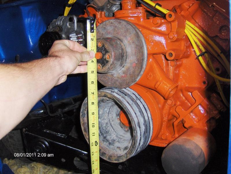

Hey guy's I went to Moparfest to day in search of a bunch of parts for my 1976 big block 400ci motor in a 1974 Plymouth Satellite. and found most of the stuff I needed but I'm, having a problem with 2 pulleys I got.The crank and water pump pulleys are hitting each other,I'm sure the A/C 4 grove crank pulley is ok but the Water pump pulley's diameter must be to big.Doe's any one know the size/s of pulleys I would need? I'm able to go back to Moparfest tomorrow if I get some answers today.Thank's in advance :)
most water pump pulleys i know of are 6 13/16 inchs diameter.
Hmmmmmmm?
As you can see the water pump pulley is way down in between the groove of the crankshaft pulley

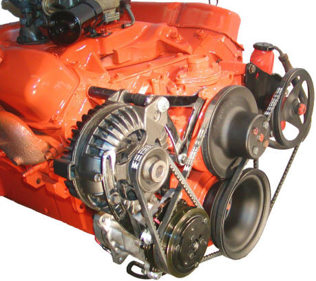

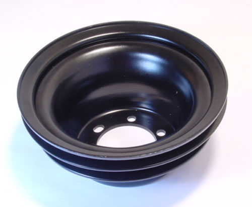

thats because you have the wrong crank pulley. you cant use a non AC top pulley with an AC crank pulley. the crank pulley you need has 2 grooves with the inside pulley having a smaller diameter. disregard the a/c compressor on the 440 below, thats not factory
