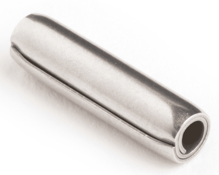

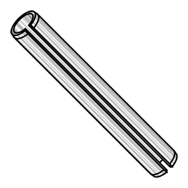

Thats a spring pin, been awhile since I installed mine but I think it's 1/4 dia. pin.
The "roll pin" that secures the housing to the shaft is 5/16" by 1 1/4" long....no taper, just an ordinary roll pin.
Spring pin
Roll pin
This is the difference between a spring pin and a roll pin but I guess it depends on which side of the Mississippi your standing on.... sorry I'm a Toolmaker so definitions are absolute in my world.

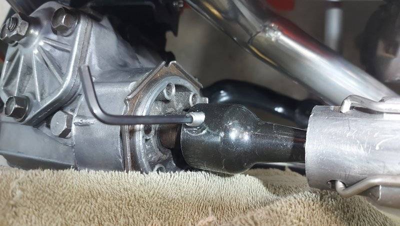

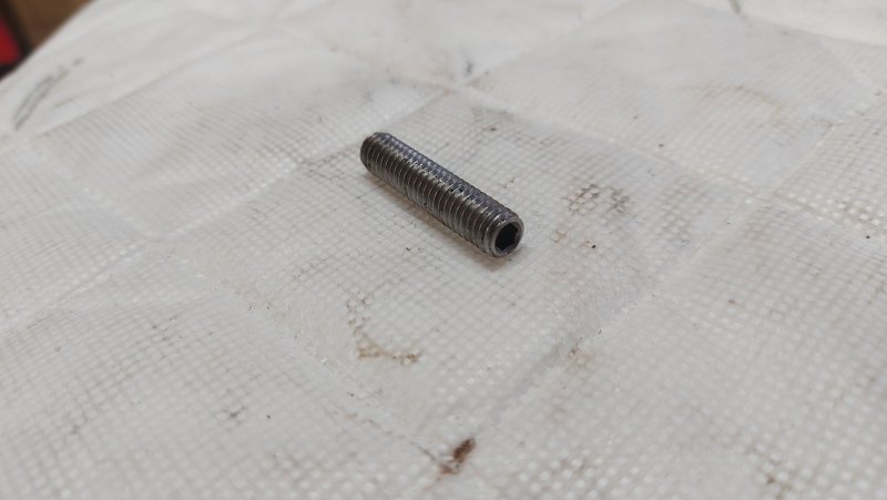

If you don't want to pound that roll pin back in you can do what I did.
I used a 5/16-18 set screw in place of the roll pin.
Just ran a 5/16 tap down the hole first and install along with some Loctite.
