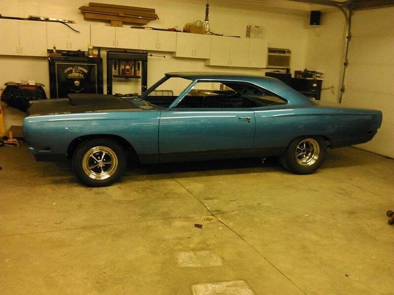

Hi everyone I have a question when I purchased my 1969 GTX it has 4 different size tires on it, I’m hoping to replace the wheels and tires but would like them staggered finally What size rim and tires should I get Thanks
Friend of mine has 10 inch Magnum 500's on the rear and 8 inch magnum 500's on the front.
15x5 in front 15x10 in back, just for a visual.
I ordered them with a 5 1/4 back space. 5 x 4.5 BC
