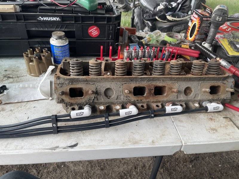

Accel 8mm ultra 9000. Set from summit. All 90 degree except for one 135 degree. Put it on cylinder 8.
