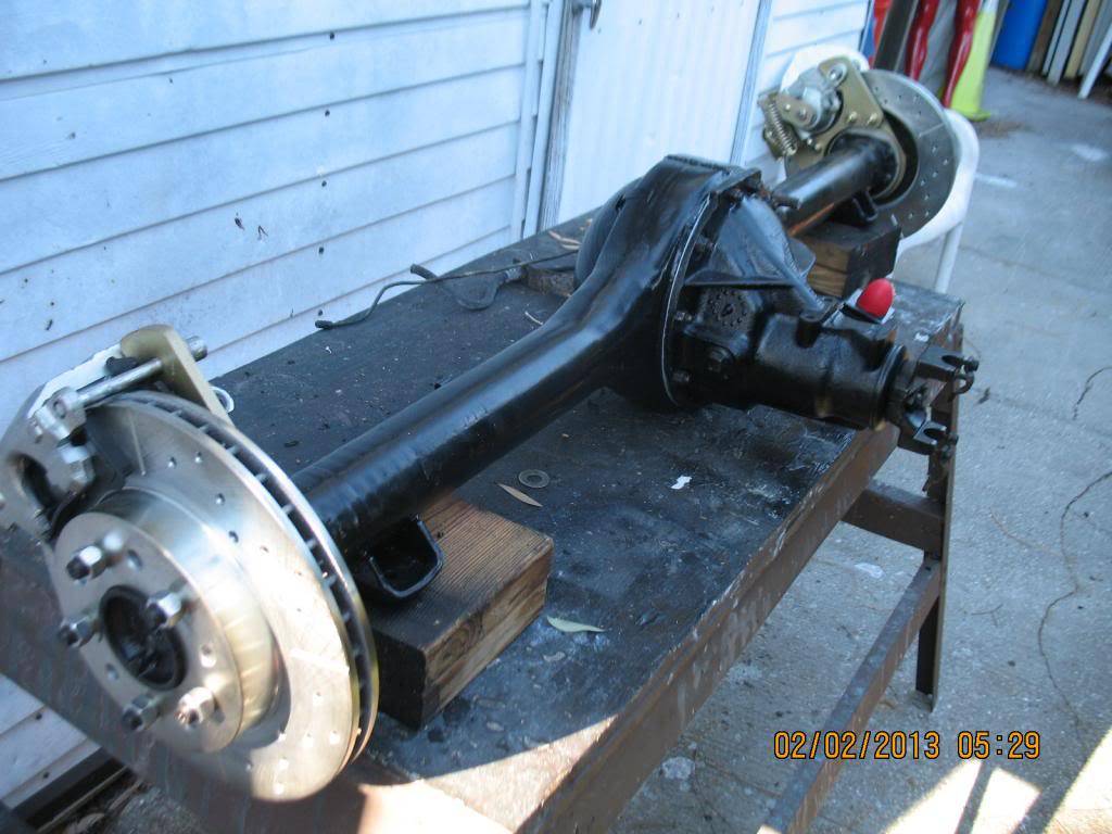

Man this is no longer a hobby its a sickness. guy gives me a 489 for free, bone yard calls about a 65 belvadere,now the snow ball has been pushed over edge. i spend five weekends and way more $ then i never had budgetted... 65 chrysler rear axle, mopar preformance bearings kit , 489 all new bearings , rebuilt dana locker, 3.55 gearing, adjustable snuber, rear disc brakes w/ emergency brake, leafs w/ poly bushings, new shocks, will transfere the sway bar off the 64's axle, and all new brake lines back. everything got a coat of por15 and or diamond clear. big thanks to all that answered newb questions on putting this toghere.
Man dude that is nice!! Where did you get the disc break set up?
