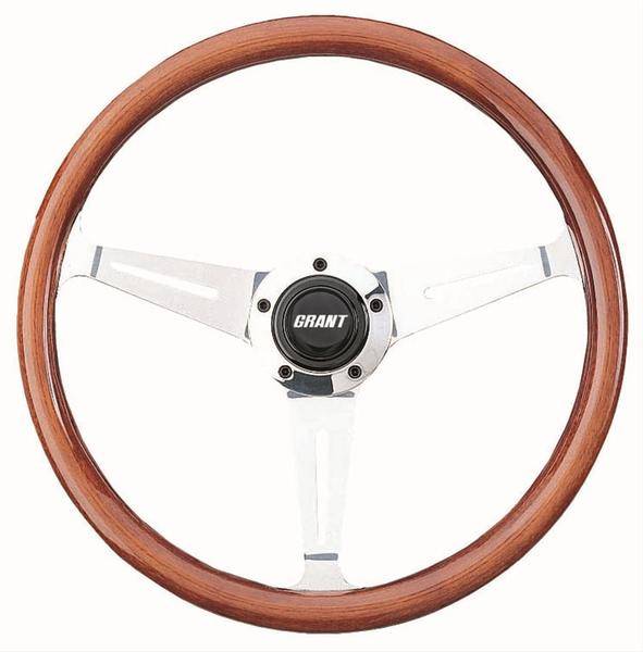

If your not dead set on a OEM wheel this one resembles the woodgrain wheel at a much cheaper price.

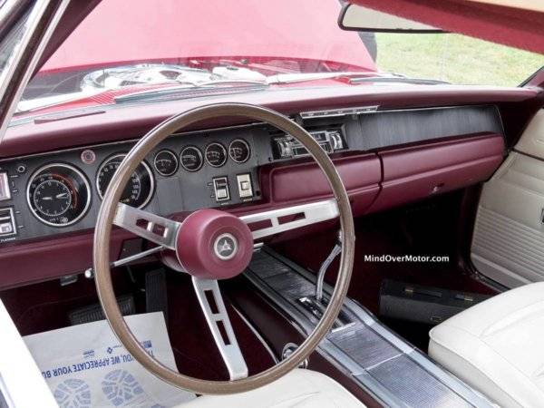

As far as the steering wheel goes the simulated either one wood look very nice. That red wheel looks nice with the white seats....but then again the wood one looks awesome (and a bit pricier...). The Grant wheel that Tim showed is a sharp looking option too. You get a free pass to choose which one you would like!

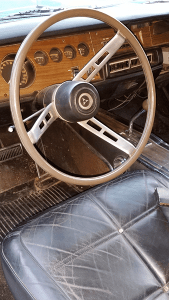

a friend of mine has a 69 SE Charger. This is his steering wheel. This is the same one that I have. Would it be appropriate for a 68? If I had it restored could it be changed to the wood grain of a 68?
View attachment 542068 a friend of mine has a 69 SE Charger. This is his steering wheel. This is the same one that I have. Would it be appropriate for a 68? If I had it restored could it be changed to the wood grain of a 68?
It's the same wheel for 68 & 69, and the wood grain would be the same between the two years.
So I can understand correcty, I have a correct steering wheel for year and model. How did they call that "wood grain" or was it a finish that has obviously worn off?
Trust me this is good news considering the price I see these going for but it needs restoration. The band on the outside is coming off in part of the wheel.
Car have power steering? I used a Grant GT cheapie for years. Much better ergo. Less dish and diameter more pleasant for daily driving. Using a Momo JPS that was given to me. Similar dimensions to the Grant.

I appreciate the real world recommendation. I plan on it being a good driver so making it more modern but keeping its original form is really appealing
