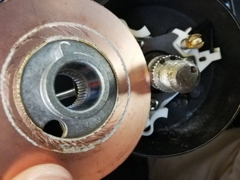

Hm, could that small wear really make that noise?You can actually see the wear already on the inside of the copper disc...

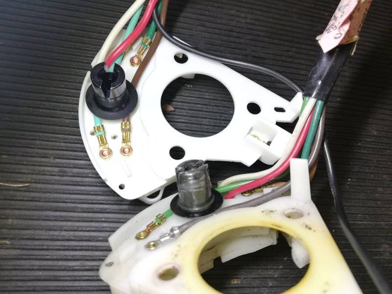

Is the head of that solder joint contacting anything like the red terminal point or the plastic of the turn-cancel mechanism?
Does the roller on the horn contact run freely? Maybe a small amount of di-electric grease will help it stay nice for longer.Hm, could that small wear really make that noise?

No, solder joint runs free. No problem there.

The little wheel on the new switch could turn....and it has edges on the wheel.
(The original switch wheel cannot be turned and the wheel is round.)
The new wheel turned and grinded my new hub to copper cereal....all to the tune of the horn going on and off when I tried to get back into the garage....

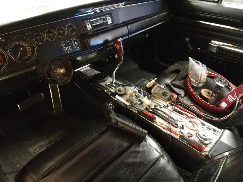

Good idea Time to narrow it down.spitballin'... pull fuses one at a time to see if it can be narrowed down?
My fat ex wife would dream of frying noises.So, last week I noticed a crackling/frying noise from the steering wheel.

Yep, that was the brand new switch that ate copper for dinner.In your picture the little wheel on the switch is at 90 degrees compared to the way the steering wheel rotates. They need to rotate together in the same direction of rotation.

This goes to show that pictures are very important when trying to help diagnose issues.It might be that the disc for the horn is slightly off-centre and the noise you hear is the extra rub when moving.
I assume that there is no noise if the wheel is not moving - that would indicate the problem is not electrical.
