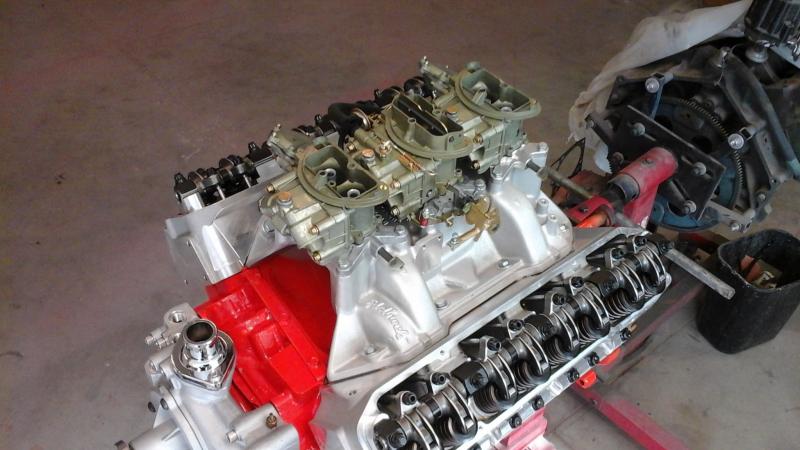

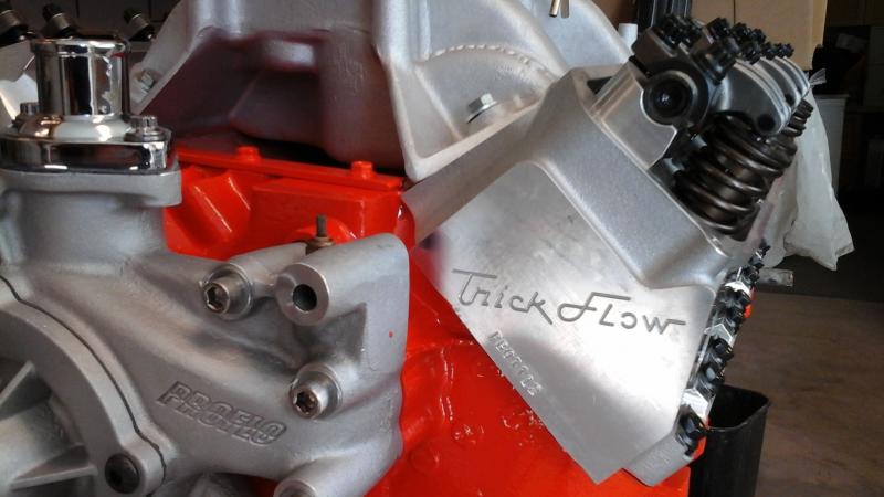

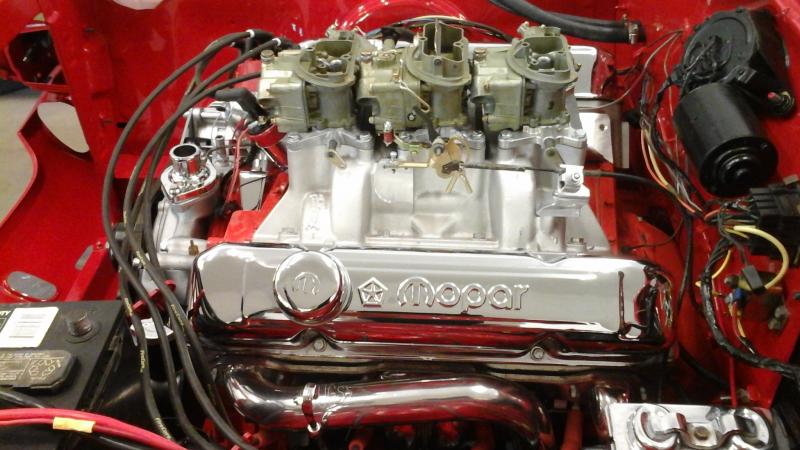

Then build it all up with a hydraulic roller and poof
And put it in the engine bay
Add a hemi 4 speed and:headbang:
I think I'll call it a day

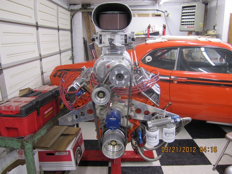

Mine looks pathetic compared to the pictures above, I feel so inadequate......I couldn't even get it right side up. IMG_0762.JPG

GPuller, the specs on the engine are 440, bored .030, @ 10 to 1 forged pistons, Lunati roller .515/.530, 270/278 dur. The Trick Flow heads were worth the 6 week wait. I was #9 on the list so others out there are happy too. The heads are finished very well, much better than the Edelbrocks. The rockers are PRW 1.5, push rods are from Smith Bros. here in my home town. I installed the PROMAX base and metering plates in the carbs, Doug's headers arrive tomorrow with Borla mufflers and 3" pipes going over the Dana rear. When done, this 70 super bee will match my Torred 69 road runner, I call them the birds and the bees.
Thanks for the nice feedback everyone. Keep the engine pics coming!

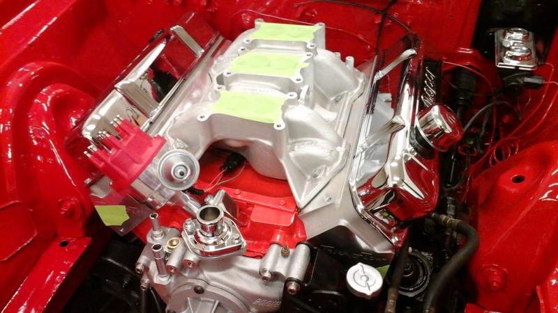

I installed the headers, starter, pullies and the alt. yesterday. When running I do hope to get it on a chassis dyno? View attachment 311124

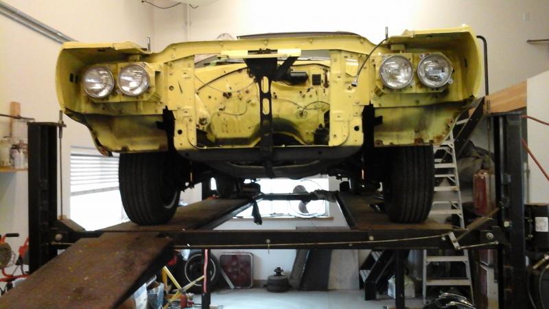

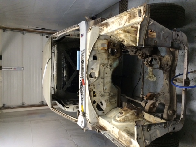

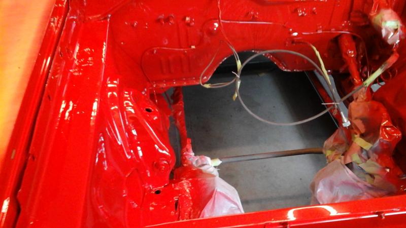

Here is the 69 RR and a shot of the 70 super bee before the engine bay was made ready20151111_045349.jpg

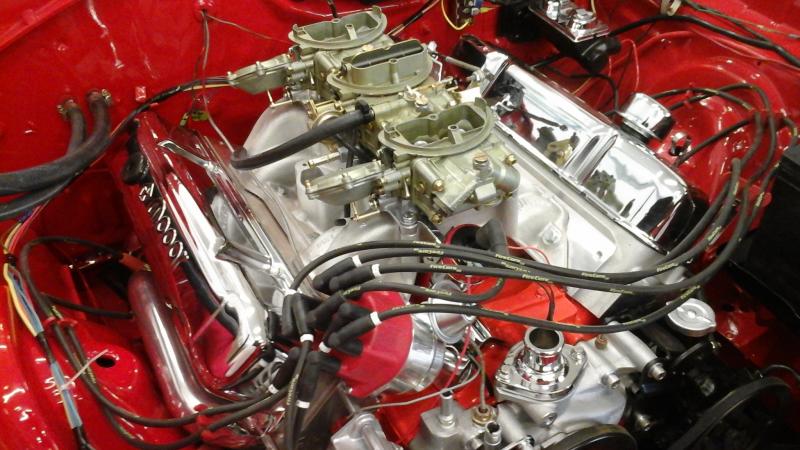

Progress is slow going but we are getting everything hooked up. Plugs, Firecore 50 ignition wires, Dougs headers, alt. P/S connected. Here are more pics.View attachment 31325020160227_185320.jpg20160312_121326.jpg20160312_121305.jpg

How do the Doug's fit, I bought a brand new set of ceramic coated 2" primaries/ 3 1/2" collector for $300 but have been worried about fitment....Don't need 2"ers but couldn't afford to pass up. Everything is looking badazzzz, keep us posted!
Thanks for the tip on phasing the distributor, 69 GTX.
Mike67, Doug's headers D452 fit great. They clear all other parts but are a job to put in. Dropping the drag link from the pitman arm and idler arm is a pain, pull the plugs, and motor mount bolts so you can rock the engine, pull the dipstick tube. Most headers sets require a mini starter, once you have cleared the way they fit great.
