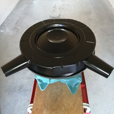

Couldn’t have been the original air cleaner then. That was a single round snorkel affair.
When the car finally arrived I found the top of a 67/69 dual snorkel air cleaner in the trunk of the car. Just need to find a correct single snorkel air cleaner for a 4 barrel

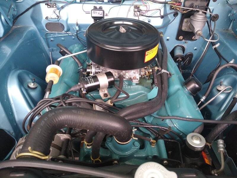

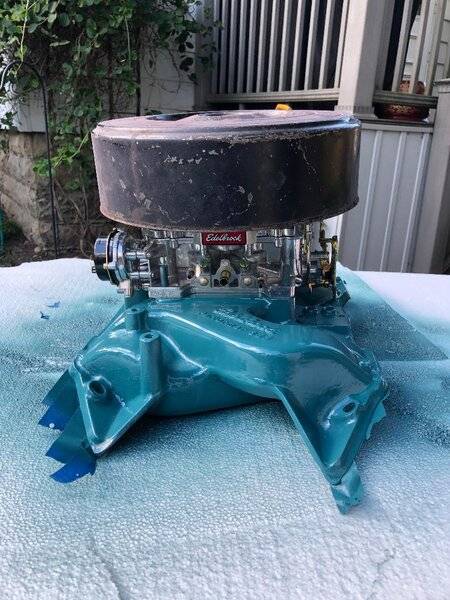

63-65 B body 383 4 bbl used a unsilenced air cleaner with no snorkel. If you go with a Holley this A/cleaner base won't fit. I would find a early 62-63 AFB and use it. That would keep everything looking original and still give a little boost in HP. In the picture I'm using a Elddy 600 which requires a different ac base also.

63-65 B body 383 4 bbl used a unsilenced air cleaner with no snorkel. If you go with a Holley this A/cleaner base won't fit. I would find a early 62-63 AFB and use it. That would keep everything looking original and still give a little boost in HP. In the picture I'm using a Elddy 600 which requires a different ac base also.View attachment 986561

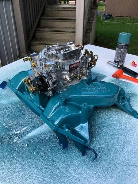

Use an Edelbrock DP4B sand the logo off and paint. 99% of the people will never spot it under a stock air cleaner. BTW use some zinc chromate primer to make the paint stick.
Well here we go.......

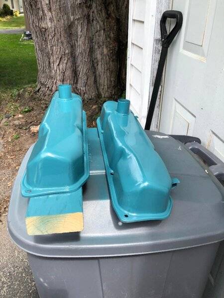

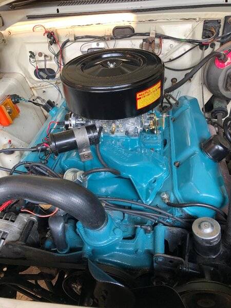

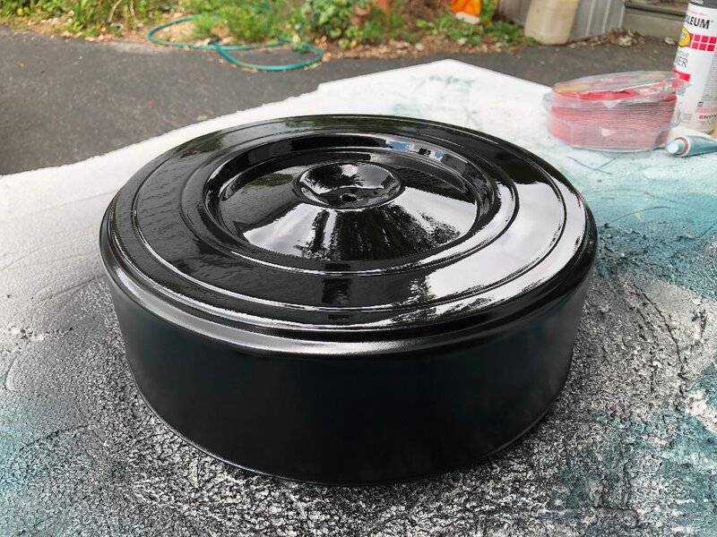

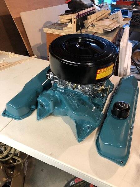

Performer intake, Edelbrock 1406 600cfm, air cleaner is an early 383 un-silenced unit that needs to be redone. I also have a set of original 1964 361 valve covers that I got from Nate (Thanks Nate). Also thanks to Barry (Fuely62) for his help too.

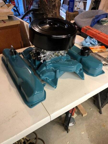

Valve covers and a wet freshly painted air cleaner. Air cleaner decal on the way from Joe Suchy
Waiting on the valve cover gaskets...

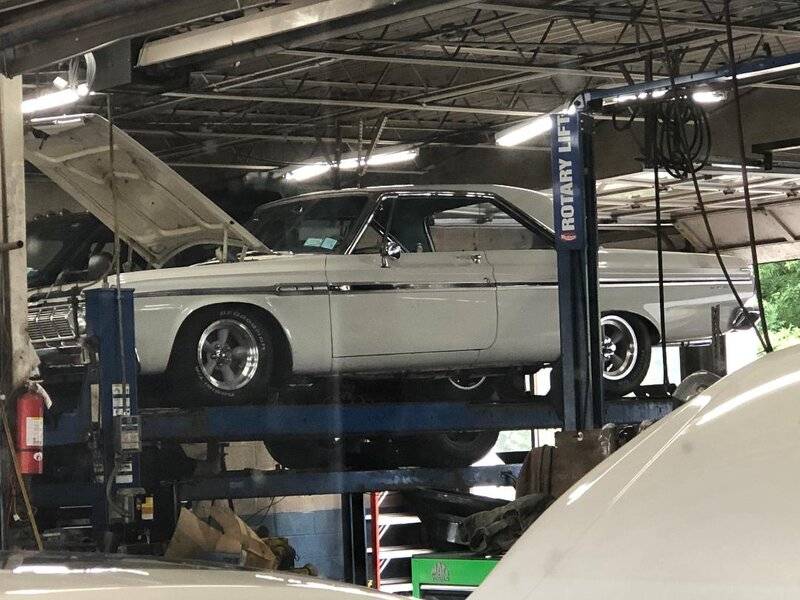

Took Mabel out today for her yearly inspection...she passed with flying colors!

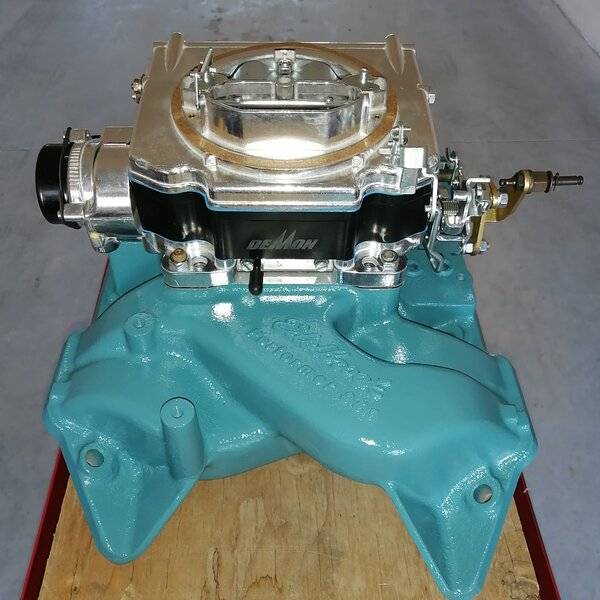

So how does it run? I have a new intake carb and air cleaner waiting to go on my 1966 361. It already has dual exhaust as well.
I haven't switched the intake and carb, I just ordered a correct fuel line but considering its still running the 500 CFM two barrel I am very impressed considering its a 56 year old 361. It has plenty of power and I'm sure I could get in enough trouble with her.
my air cleaner is original and the yellow sticker isn't as large

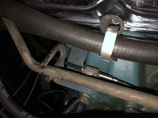

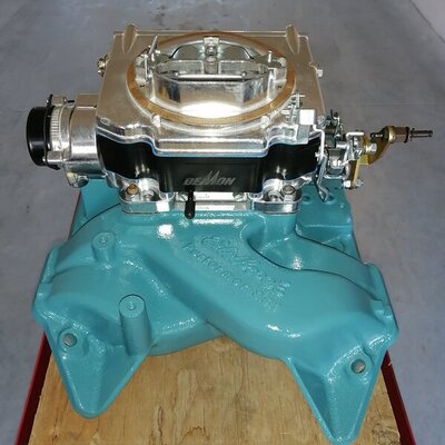

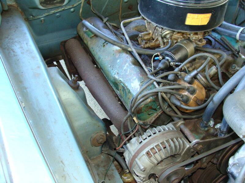

Did the conversion today......still waiting for a fuel line fitting along with what to do with my throttle bracket and the throttle return spring bracket. Still need to button things up but with waiting to solve some problems there is no rush.
Before
After

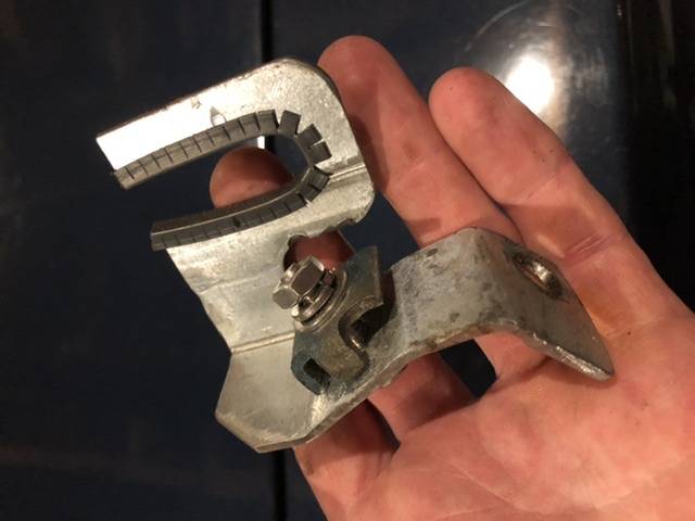

Looks like you need a new throttle/ kickdown bracket like this:
I temporarily used a home made one like this:
want it?
How about loaning it until I can get what I need......rental fee.....
