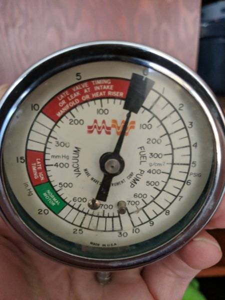

Do you have a foto of the dial face of the vacuum gauge? I would like to see the scale. Thank you.
Here it is
With that vacuum everything depending on it
will be fine
