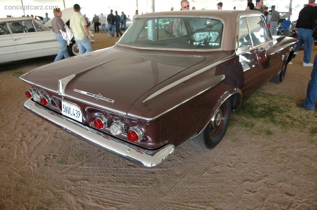

I have a 62 Fury and i have never been able to read anywhere that is clear What the difference between the 62 Fury Savoy and Belvedere. I know the fury has major trim changes from first have and second have year models. Plus all Furys trim seem to be a little different depending on how they felt the day they were building it. The one thing that seems to stick out to me and i could be wrong is Furys had 6 tail lights. Belvedere had four and Savoy only had 2. At least on the body. Anyone know forsure.

Here is my Belvedere with factory trim. Mine has 2 tail lights and 2 reverse lights, which were optional. Fury trim seems to be much wider.
Savoy is strictly a sedan (piller). Belvedere could be either sedan or hardtop while Fury and Sport Fury were hardtops. Trim changed by model and build date. Later builds had more bling to try and move more units.

I had a 62 Savoy sedan with two taillights and two backup lights. I think the lights counts on the Savoy and Belvedere depended on options.
