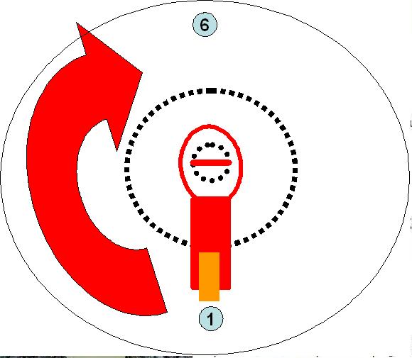

You are now 180 out. The pump shaft is still in the correct position because the slot is 180 degrees across already. Simple, pull the distributor take the cap off and rotate the rotor 180 and reinstall. Don't rotate the motor, just the distributor shaft. Do not move the wires on the cap.

I like it! It all looks correct, yet it is working off the #6 cylinder.

That is true but the OP's objective is to have the #1 cap position pointing toward the #1 cylinder as stated in his first post.
The OP's first post mentioned nothing about #1 cap position, but did say that he thought it was 180 out. This was just a quick and easy way to verify. By now, he's probably pulled and rotated it anyway. :)
Problem has been resolved, thank you to all for the help. I did a little of everything and it is perfect now. Wires lined up correctly, the dizzy (rotor) is pointing towards #1 and the engine starts right up. Timing tape installed and now I am just waiting on a free day to get a timing light.
