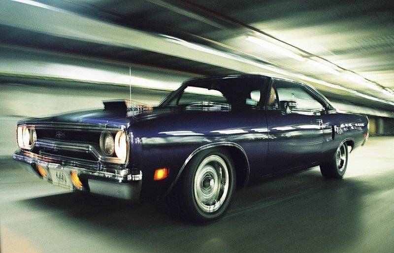

My '70 Road Runner was kitted out with a 440 and 4-speed....with 3.23:1 rear gears. That was a little hard on the clutch, but made for awesome top speeds on the open road (back in the days when cops had less radar, and not as many speed cameras). I also set a New Zealand land-speed record in this car for towing a BBQ Trailer - reaching 140mph before running out of road. :)
The RR also did great 3rd gear burnouts when required.....quite hard on the drivetrain, but it worked.
This car was also the one where I did the first & last Full 1/4-mile burnout at the local dragstrip. I have video proof of that day and a neat picture.
