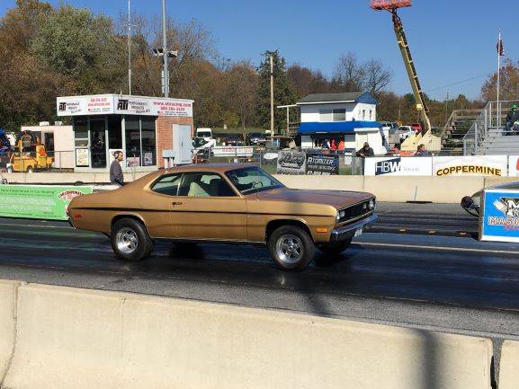

The 72 Duster has a 3.55's with a 416 and a 727 and the 3500 convertor makes it pretty decent to around 65 mph...

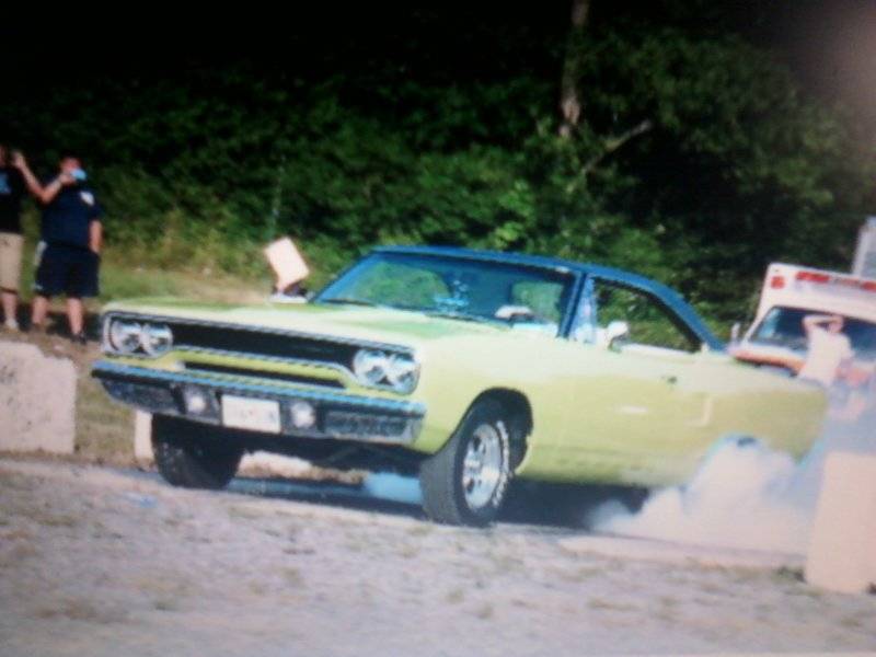

i've had everything from stock 3.23 to 4.86 in my roadrunner but now i have a 4.30 gear in it for the last 28 years

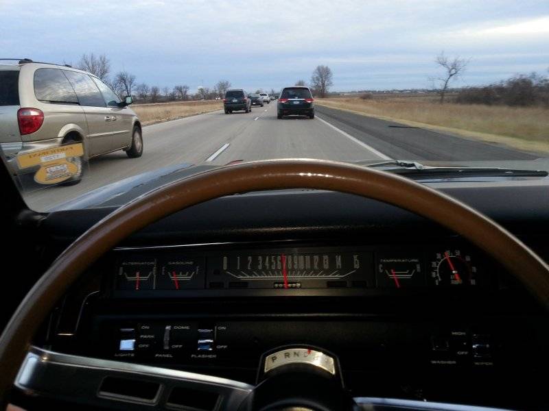

5.7 Hemi, 545RFE Transmission, 323 gears. I'm not worried about being the quickest around town, it's the highway I'm concerned about. I spent years driving around with tractor gears, no thanks.

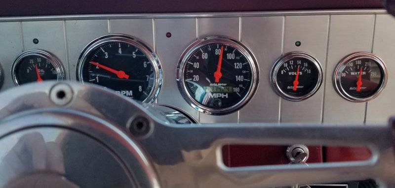

We have 275/60x15 and 3:54 gears. I think 3000 rpm gave me 65MPH. Don’t really like running at 3500 rpm. It’s been 4 years since we started this refurbish. Just have to get the car completed.
