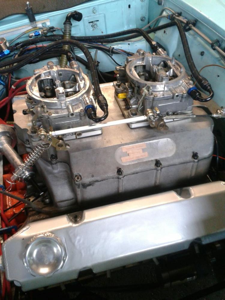

They look natural under old B Bodies

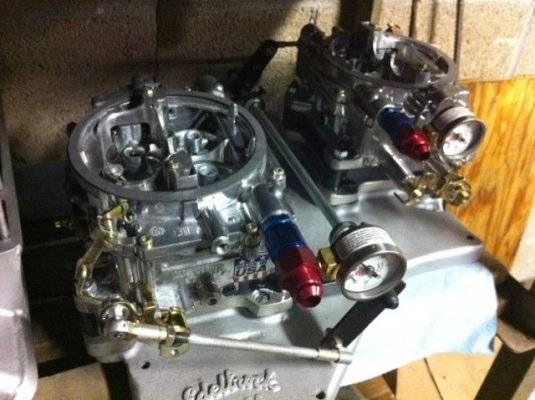

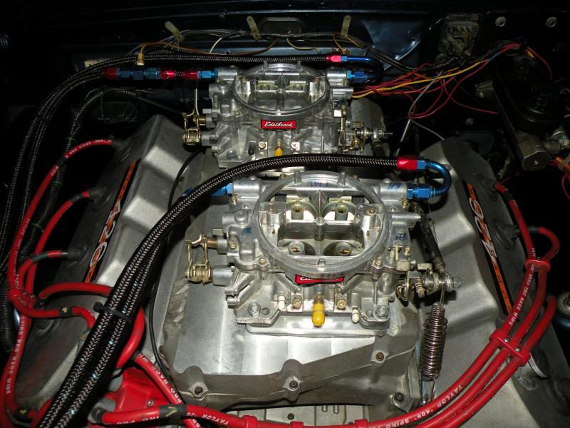

Interesting fuel press gauges there nomax .. never seen that setup before
mine purr like a lion.
