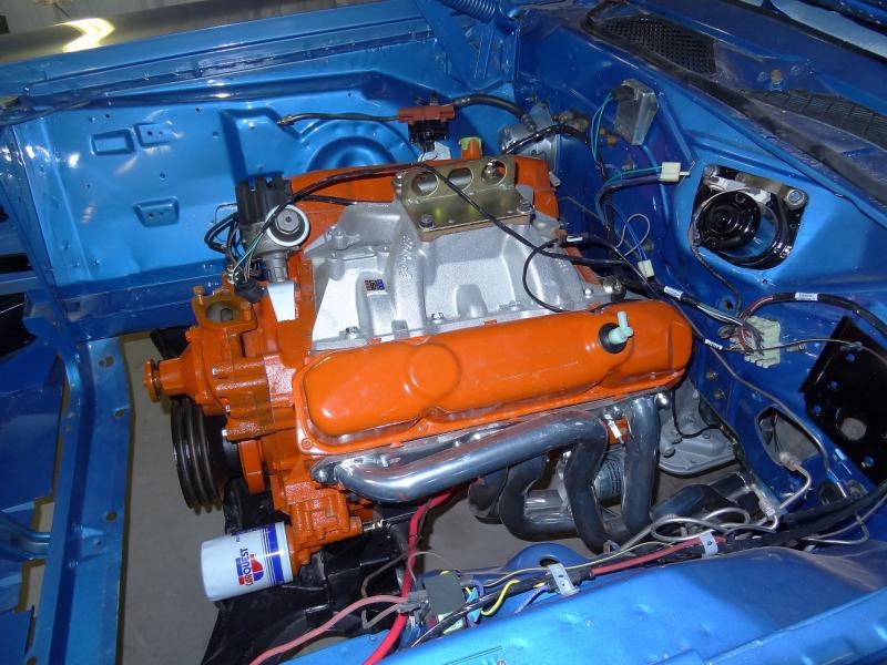

I was asked if I would post a pic of the brakes on....sorry I don't have one just yet. The car is being reassembled about 350 miles away. Here is the last "update pic" that I took a few weeks ago.

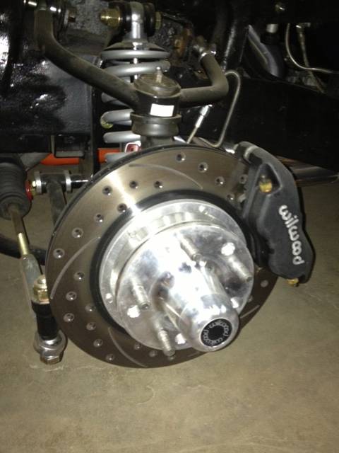

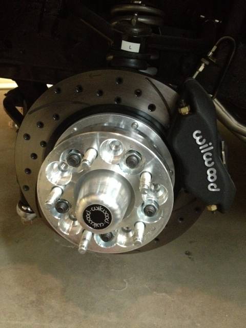

Willwoods will not fit a Magnum 500 without a bolt on hub spacer on the steer axle. The rear axle is fine as long as the back space is 5" or less. A Magnum center is 2 1/4" where as the Willwood hub is almost 3", 74mm to be exact I believe? See the photos below.
1" universal hub spacer. I do not recommend this type of spacer. Get the 1 1/4" Trans Dapt 4 1/2" x 4 1/2" spacer instead. I have a pair coming for my own car. The Trans Dapt 4 1/2" spacer offsets the wheel studs evenly which works better for a 17" Year One cast Magnum or cast Rally setup. Reason being is there is recesses between the lug bolt holes on the back side of the Year One cast rims. So if you wheel stud sticks out slightly, it clears the back side of the rim just fine.
Here is the setup without the spacer.

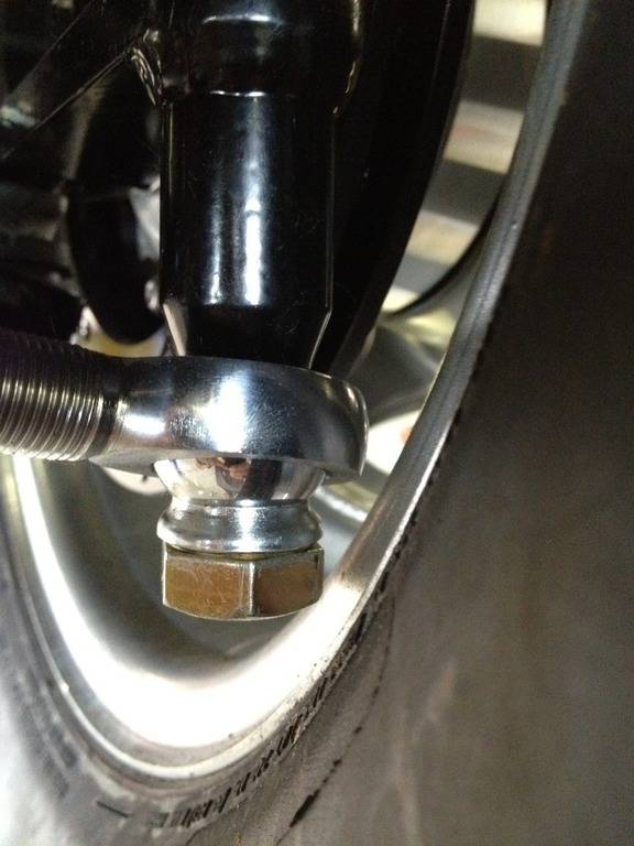

The reason I could not get the 15" rally to fit on the front of my car had nothing to do with the Willwood brake or the hub. Rally centers are bigger 2 7/8" and clear a Willwood hub. It was to do with the RMS tubular front end. When you run this style front end, you can only use a 15" rim with 3 1/4" back space ore else it hits the tie rod end. So a 1" spacer gives you 4 1/4" so you can then run the 15X7 Rally or Magnum.
