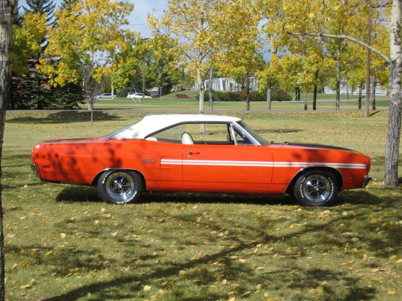

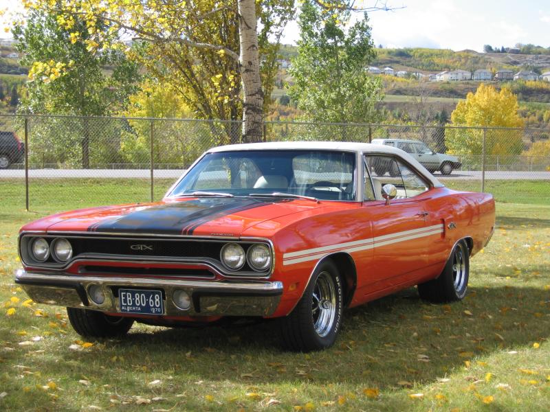

When I bought new wheels I got them from Specialty wheels in Portland..Mike did a great job of the custom sizes and pricing was good too! IMG_3338.jpgIMG_3341.jpg

That's beautiful, you really nailed it with the wheel tire profile, nice stance. That's how they should have came from the factory IMO.

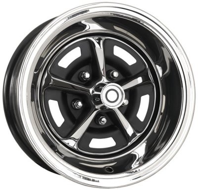

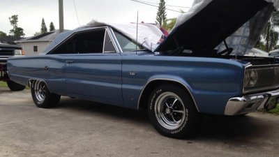

Motor Wheel Corporation - Magnum 500's

So actually the picture with the chrome spokes and chrome trim rings are not "factory". They don't look bad though.
Coker tire references the Road Wheels as the wheels with trim rings (and black paint on the rim rather than chrome). For them, the Magnum 500 is the wheel that has a chrome wheel and is typically used without trim rings.
There seems to be quite a bit of confusion with the naming. The centers of both wheels are the same, so check for paint vs. chrome and go from there - whatever they are called.
