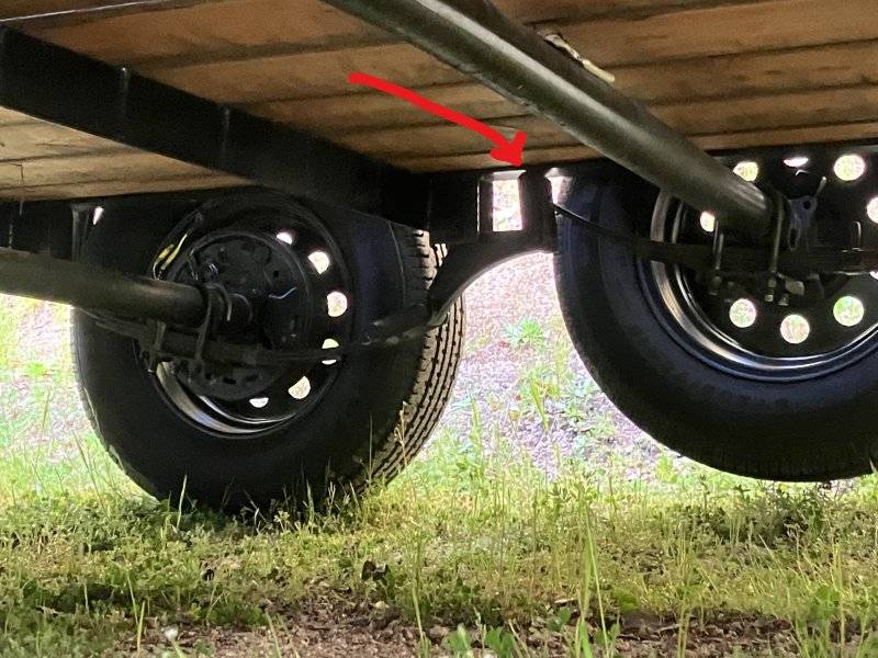

The front axle is hanging up and the tires aren't touching the ground.

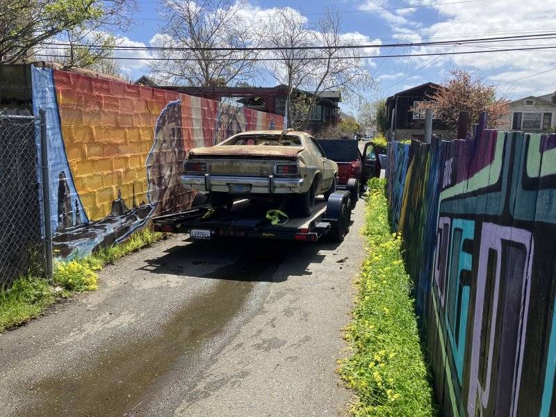

I had this car on it today:

At one point I went through a parking lot over a speed bump and heard a smack-slap sound. When I parked, I noticed that the rear axle and tires were the only ones touching the ground. I thought that maybe I had the car too far rearward or forward but after unloading, the axles stayed this way.
The trailer was bought new last year.
I wonder if the smacking sound was from when this shackle piece hit the underside of the deck...?

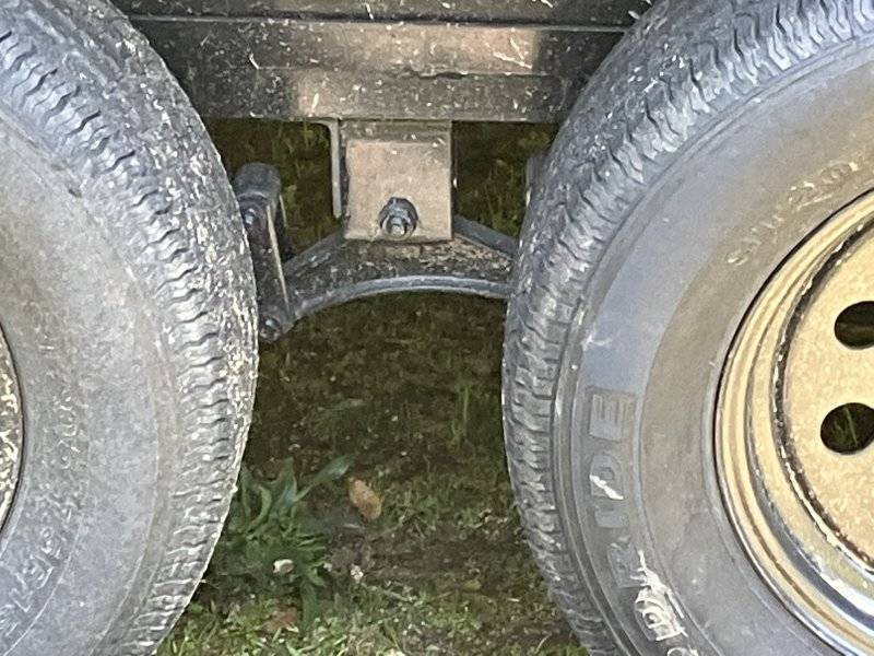

Looks to me Greg, that your walking beam / equalizer bar is jammed
Have you tried loosening that bolt in the center
Is it still jammed?
Is it still jammed?

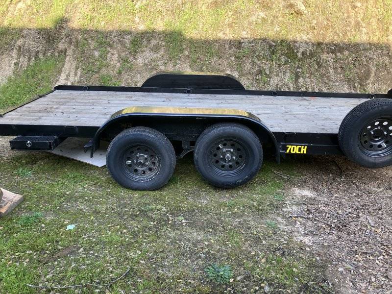

What is rated for? Per axle?
That Duster couldn’t be much more then 3000 lbs
Even lighter now. Lol
I thought it was an 8000 lb rated trailer. I thought I had the papers right here but they may be in the truck.

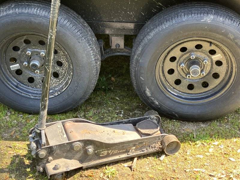

Grab your floor jack & lift at the front end of the rear spring....

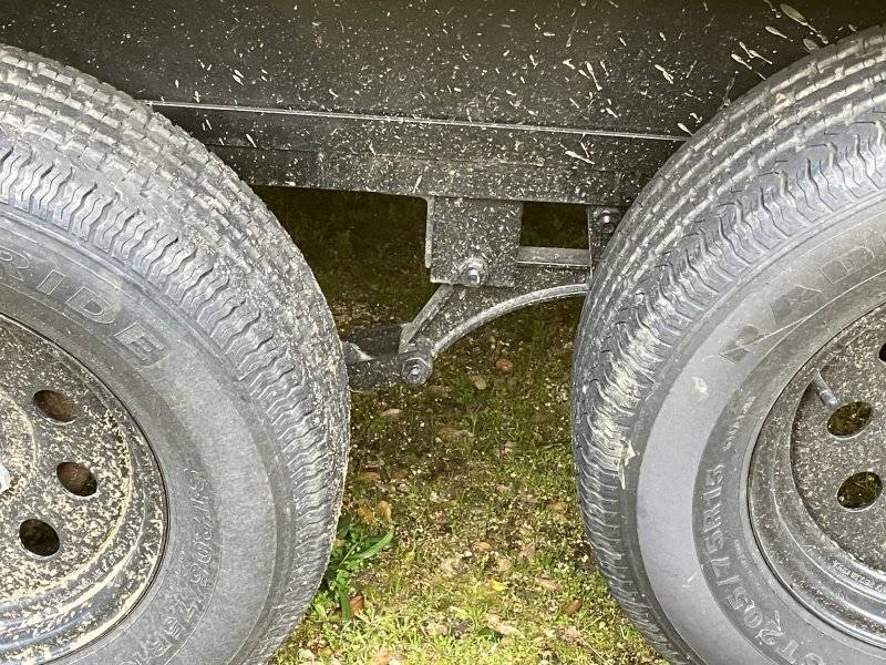

The spring didn’t spring and just flipped the shackle
Was it loaded at the time?
Anyway nothing broke just a pita to flip it back

My pontoon boat trailer does that almost every time that I launch from a ramp near me. It has a pretty sharp crown at the top of the ramp and with the weight of the boat it lets the trailer suspension overextend (doesn't do it when empty) when it rolls over the peak of the crown. I fix it by prying, but you need to be careful because it unbinds with a lot of force.

Big pry bar, big bang.
I'm thinking that the spacing is off. Who ever built the trailer didn't weld the tabs at the correct distance.
