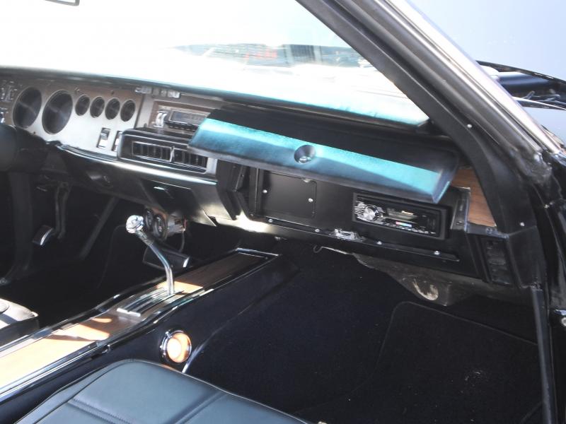

P9270005.jpgI have stereos in the glove box of my 70 Challenger and 69 Daytona. I had the stereo in my 68 Charger when I sold it. It is easy to install and can be easily controled with a remote. Down side is you lose the storage space in the glove box (I have consoles in both cars for storage and just don't keep that much junk in those cars any way). and the glove box has to be open to use the remote. The upside, depending on the syatem you choose it is likely cheaper than "hidden stereo"

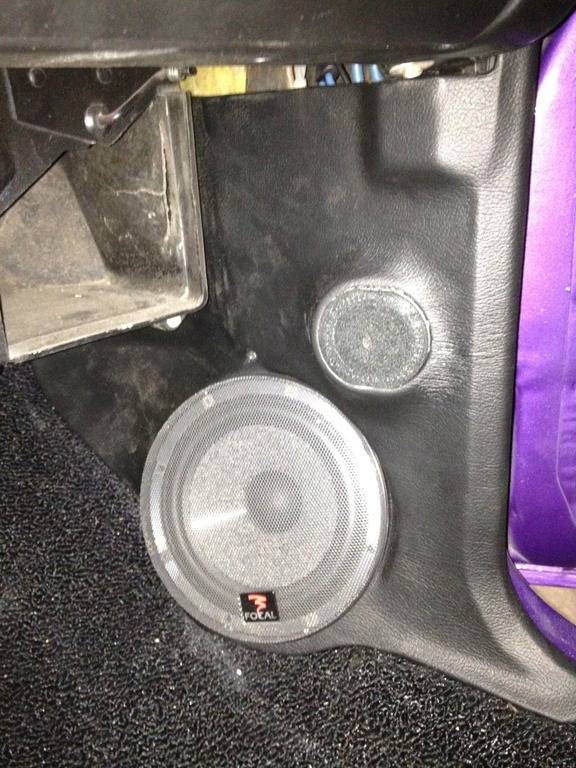

I did a custom Focal 6 1/2 component in the kick panel and use a JBL MS8 which is hidden in the ash tray. The iPod sits in the console as I only use it. Decided not to use a deck as I am on my iPod 99% of the time. Have a single JL 10W7 in a custom enclosure in the trunk. Didn't want to cut into the door panel and wanted a stealth stock look. It sounds amazing.
Here is the inside of the console. Dual accessory plug ins. Bass control for the sub and iPod/MP3 connections. Volume is controlled by MS8 remote. Also have my line lock switch hiding in the console.
Very happy how it all turned out.

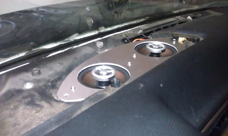

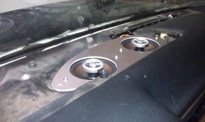

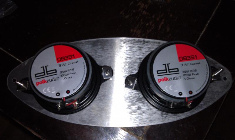

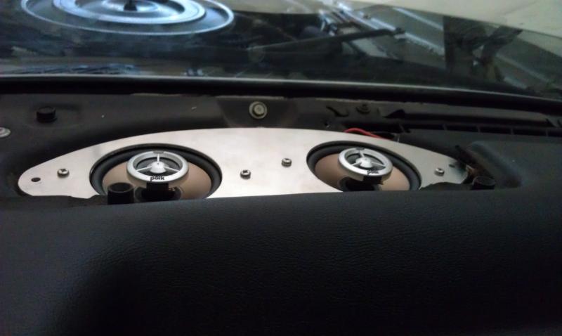

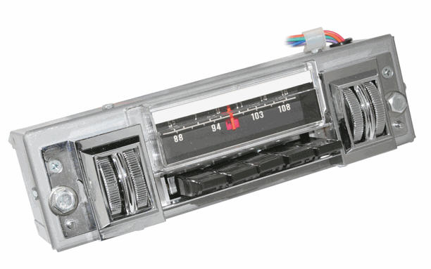

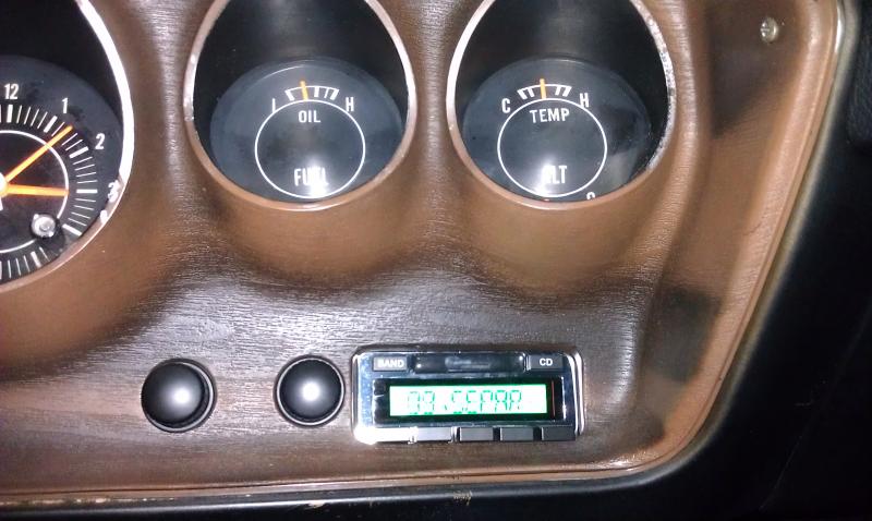

I went with a custom auto sound stereo I found on ebay fit just like stock no modifying and it sounds great I opted out on the cd changer and just use the usbs as cds which I ran the cord to my glovy. For the center speaker in the dash I bought the adapter plate from a member on here and put 2 3.5s in it works great. As far as the rear speakers go I used 2 6x9s on the left where it is setup for the defrost I mounted just like the other side only needed to make four new holes to mount speaker and the edge didn't interfere with the woofer at all.IMAG0251.jpgIMAG0252.jpgIMAG0253.jpgIMAG0354.jpg

also i forgot to mention that the deck i have also has a input to hook mp3s or phones as well. for bass I actually do have a sub box in the trunk with 2 12s and a big amp that runs my 6x9s and my 12s.

I will need an adapter plate as well, is that something the other member fabricated? Or is there a place i can look to find one?
That looks real good.. I didn't even hide mine, just keep it under the dash sitting at an angle onto the console.. I do like this idea though!
