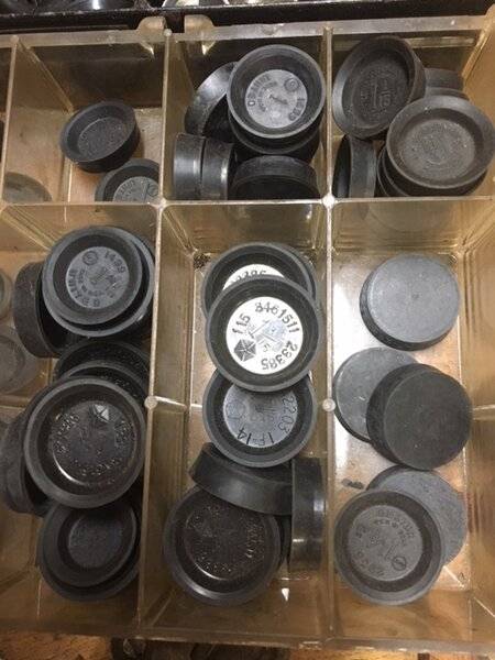

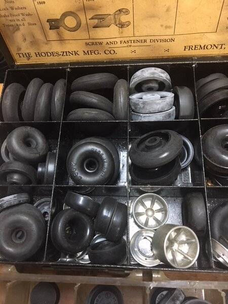

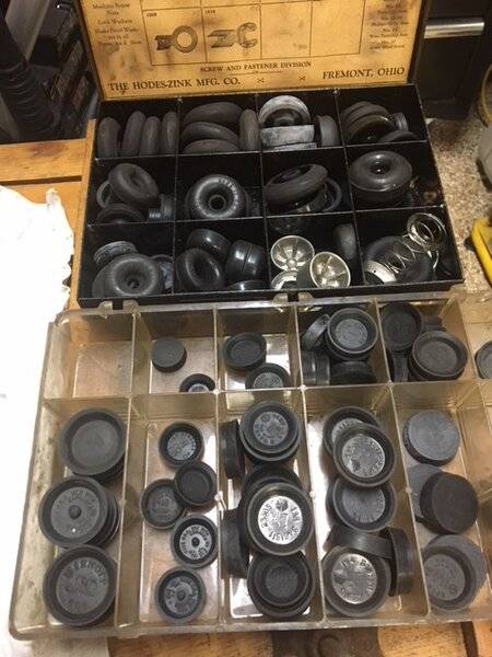

Apple hydraulics, white post . Take your original ones, if you still have them. Send them out to be sleeved stainless, bronze sleeves. I did the master cylinder and the wheel cylinders Years back. No more stuck rusty cylinders either. Found old raybestos wheel cylinder cups, usa on ebay bought so many he just sent me the rest for free. But they are good old usa. And still in fine condition.i didn't like China then, like them even less now.
