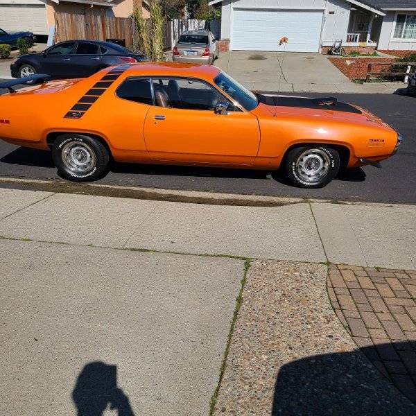

Vitamin C has a small amount of metallic. Just finished my road runner in vitamin c with Glasurit single stage enamel. Then ended up having it cleared over.
