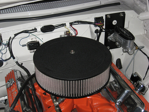

Never painted chrome before. Sanded with 1500. Painted it with High Heat Stove BBQ Black then hit it with some vht black wrinkle.The wife was home so I couldnt put it in the oven like Ive done before.I set it out in the hot sun and
it came out really nice..thanks for the advice:)

Looks good. Does a pie tin fit on it ?
I don't think it'll look right, the tin's are small in diameter.
Rob, I had this one on my 70 Cuda. Looked pretty good.
His lid looks typical aftermarket Mr.Gasket style lid. Yours looks like a cut down OE lid. If it isn't, ..........OK Also, his lid looks flat. (?)
Damn that looks slick. Same lid as mine it should fit good.
Mancini? Should I get a 440 one or a 273 one just to confuse people?
My lid is a cheap after market chrome one. Its not flat though it does have a cone shape in the middle.
