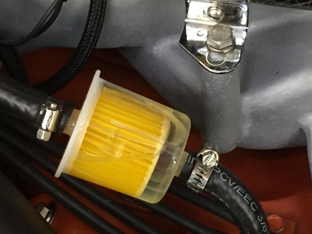

I finished up the installation of all the NEW components, added fuel, opened the garage door, started the car. Fuel filter filled to
almost full, gas cap loose and ran the car at idle (850 RPMs) for about 25 minutes. Shut it off, walked to the front and saw the fuel filter was empty. Started it back up, fuel filter stayed (empty) but had almost 6 psi of pressure (intake was hot, but carb was cool, all fuel lines are cold. I let it cool down for about 30 minutes, fuel filter filled a little. Not enough to run under acceleration. SOOOOOOO.. What electric fuel pump is recommended????

FYI.. at lunch I looked at the fuel filter.. ha, it was almost full!! of course, the engine is cold. Narrowing the issue down... as Purplebeeper stated, definitely vapor lock at the carburetor. question - will an electric fuel pump solve my problem?

Apologize for not keeping up here, had to hit the road for work. I FINALLY solved my fuel starvation (vapor lock) issue at the fuel filter. Solution = installing a return line on my '67. You are correct, there is not a return line available. Vapor pressure was overcoming the fuel pressure, hence the fuel in the fuel filter would keep reducing in the amount of fuel in it. With the temporary return line (1/4" with a .060" orifice) the filter stayed 3/4 to 7/8 full from idle up to 2500 RPM and engine at 185 degrees. Now, i have asked Right Stuff to build a 1/4" fuel line (might be toooo expensive) and i will add a 1/4" tube on the sending unit. I will also try the NAPA 3041 filter (with the return line port and oriffice in it). I will reply once i have the return line installed. I am running an electric fuel pump but will try the mechanical pump also.. thx
