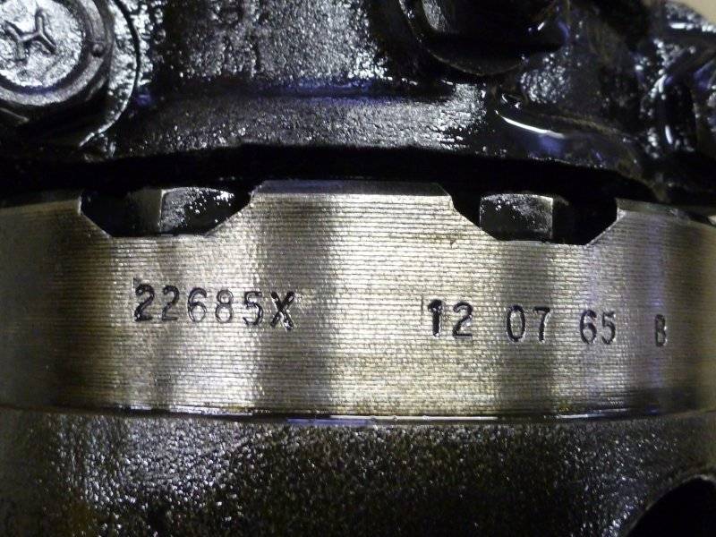

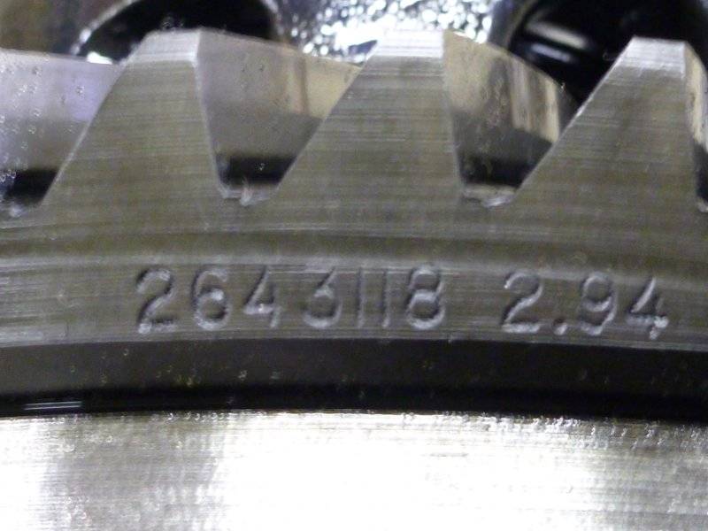

Interesting as the rear axle in the back of my Bee came out of what I remember was a '66 Charger... but it could have been anything 1966 in the junk yard at the time. 2.94 Suregrip 741 case.
Interesting as the rear axle in the back of my Bee came out of what I remember was a '67 Charger... but it could have been anything 1967 in the junk yard at the time. 2.94 Suregrip 741 case.
All GTX'S with 8 3/4's were 742 housings. The 741 housings were for the small blocks.
