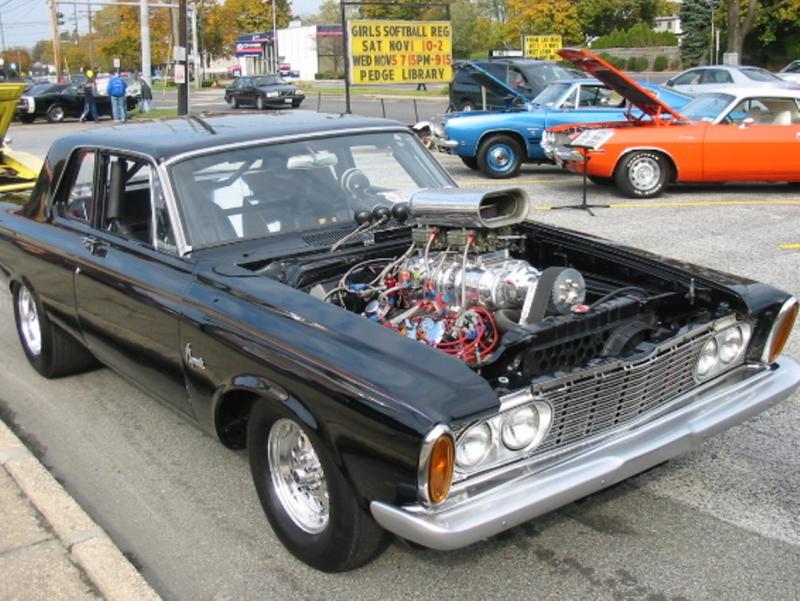

I personally don't care for 3rd gen Hemi's in old school cars.I know you CAN make good power with them,but I'm an old school knda guy:headbang:
