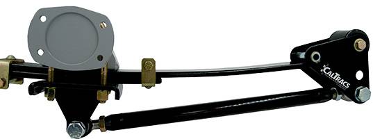

On the Calvert racing website it has a pic of cal tracks with oem spring pack,actually the pic is right under the pic that you posted so i have some confusion as to how cal tracks should only be used with mono leaf springs. Cal tracks so they don't have to buy spring clamps ,i don't understand.
I see you changed your post but just so you know, I wasn't being snarky. My intent was just to point out that there is always going to be those people who "do it their own way" and think they know how to make their junk work better than say the guy who designed one of the more successful racing products to come out in the last 30 years. Not saying that's you but by using the parts that allow the system to perform optimally you eliminate any guessing. What's the point of tying to use a band aid device (Caltracs) on a compromised passenger car component (leaf springs) in a half-assed manner? Do you put half a band aid on a cut?
Like most all components of a passenger car, leaf springs are a compromise between some level of performance and passenger comfort. Compromised parts will always limit performance to some degree no matter what you do to mitigate it. Until you replace the compromised part with a "race only" piece, you're fighting an uphill battle. Some guys are good at winning the battle but most, me included, would rather pay the man, use the right parts and move on to the next thing.

Incidentally, the Calvert system was developed using all sorts of different springs but the best results came from the split-mono arrangement. Can multi-leaf springs be used? Sure. Will they yield the best results? No.
Here's a statement from John Calvert himself.
...“In regards to the leaf spring itself, we’ve tried many different combinations over the years — multi-leaf, multi-leaf with an added thick leaf, multi-leaf with very thick leaves, multi-leaf with only one back leaf (suspend the car with coil over shocks), mono-leaf, parabolic mono-leaf, and split mono-leaf. The latter is our current preference,” Calvert says."
So, is it worth spending the $400 or so on the Caltrac hardware without shelling out the coin for the split-mono leaf springs? In my opinion, not really. If you think the system is too expensive for what it is, perhaps that's true. There are plenty of guys out there who are sorta fast on Super Stock springs but they could probably be a little faster with the proven band aid device working as designed.
Don't mean to piss anyone off here, nor do I work for Calvert, just giving an opinion, take it for what its worth. Leaf springs have come a long way and work just fine for most applications well into the 9s and beyond. I don't ever see myself in a car with something other than leaf springs so I'm there with ya. All I'm saying is that if you had the choice, you'd probably want to take advantage of using whatever thing gets the car down the track the quickest.
