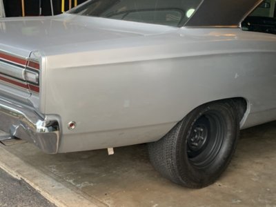

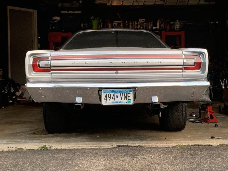

I was expecting my SS springs to raise the rear a lot but they didn't. My car sits pretty low, a little too low for me. I think the newer ones are made in a different place and seem saggier if that makes sense.
