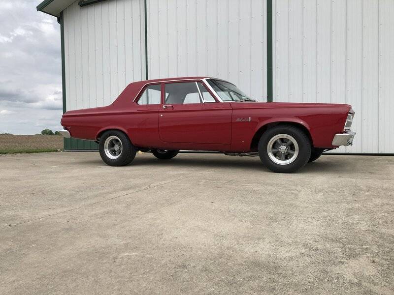

Cragar G/T's up front and 295/55/15 tires on the back with an 8" steel rim.

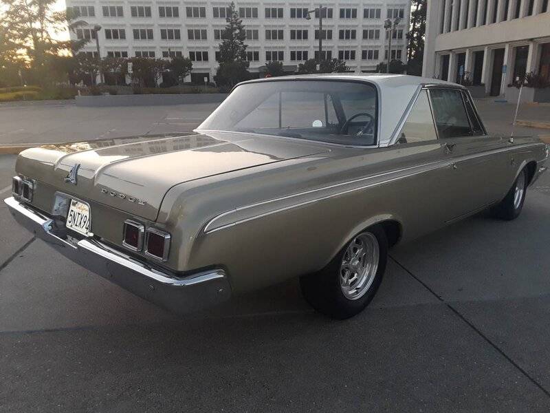

I prefer wheels that compliment the color scheme, body lines and/or trim of the car. Your car already looks great, and I like the polished wheels as they bring out the trim of the car. Another possibility is to go with a dark rim that helps contrast with the light body.
I think the good news is that with a car that nice you probably have a wide range of options that will look nice!
Good luck!

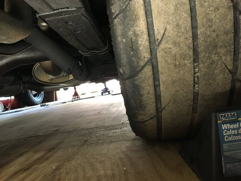

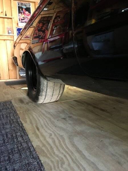

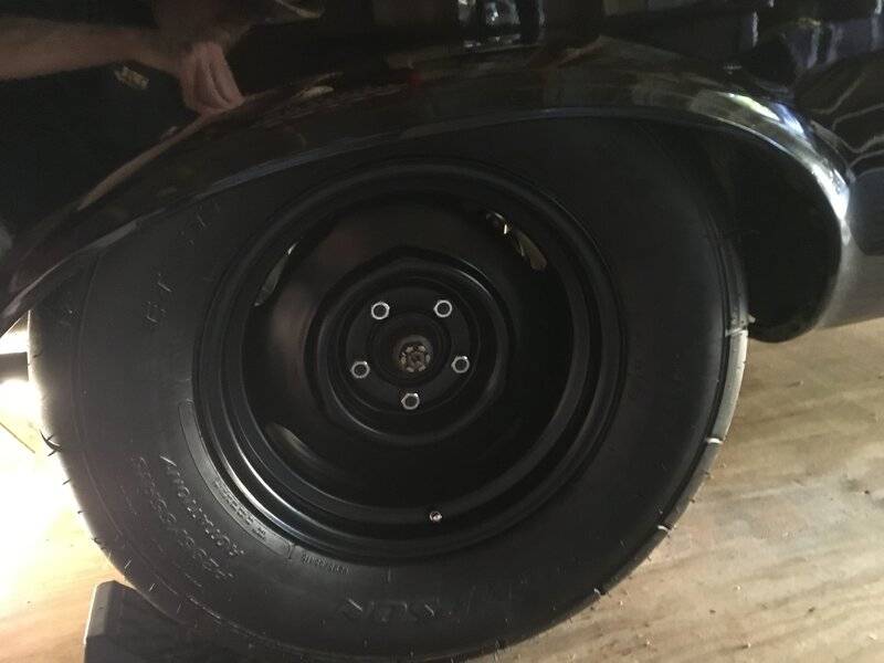

295's fit without any mods?
I dont know about Preachr's car, but yes, i think it can be done, but only with the perfect backsace on the rims
(Note: theoretically a 295 should be on a ten inch rim, hasnt stopped me from using an eight or eight and a half). A 295 is supposed to be 11.6 section width. I have a 62 (similar wheelwell size and shape to your 64) with a 12 1/2 section on my car, now. BUT, it is probably too tight for street use, and it has ss springs. Im sure they would rub at stock ride height.
If you want to try that size, careful measurements are required. I think you will be happier with 275s.
Yeah, there close , but they fit . 15 x 8 with a 5 1/4" back space, Thats stock under there. I can't seem to locate the pic of the outer side. If memory serves me that what your looking at is 1" but like I say it hasn't rubbed.

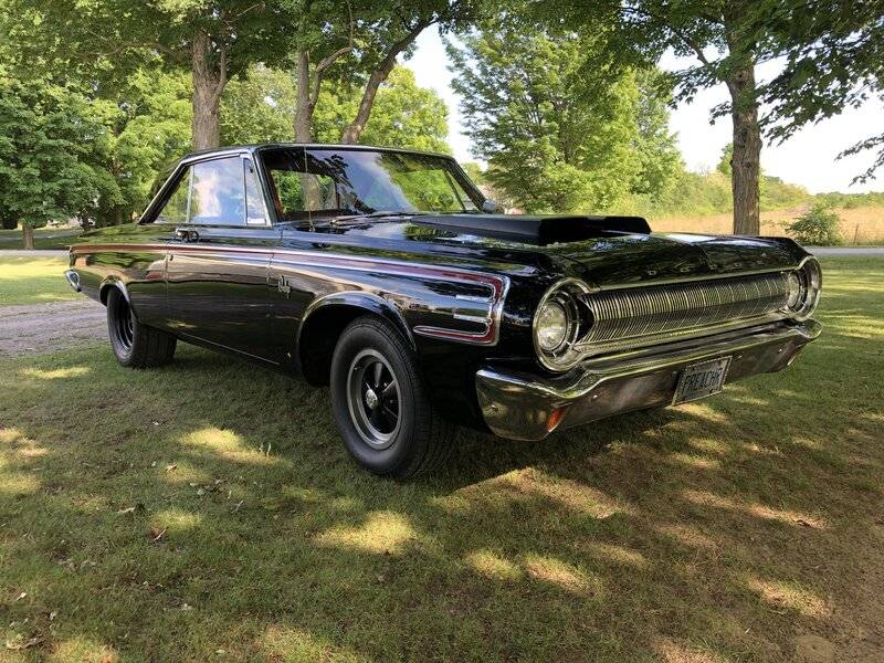

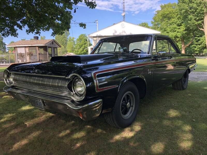

View attachment 1125346 I should also mention I'm heading for the 60's SS look when I was young. Pretty much all the wheels look great on these cars.
I would also like to stroke the 440 in it and go with the maxwedge hood scoop but not sure if I'll get to that point[/QUOTE
That car was for sale, did u buy it (San Mateo?)

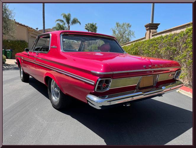

Thought I'd update this. I THOUGHT I HAD BOUGHT THIS 64 but on the day it was to be delivered the owner calls and says they went to load on trailer but the trans is locked up, WTF? Checks back in a couple days and says not sure the problem Long story short he sent my money back and I never got that car

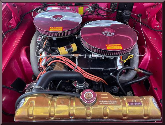

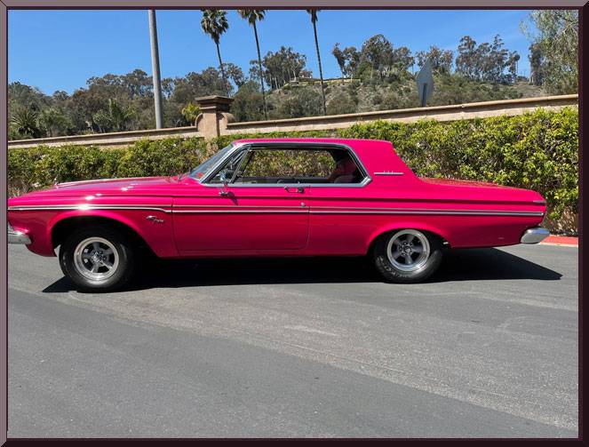

BUT I just got this MaxWedge clone yesterday 9/11
1963PlymFuryPinkBG-side.jpg 1963PlymFuryPinkBG-engine.jpg 1963PlymFuryPinkBG-back.jpg
