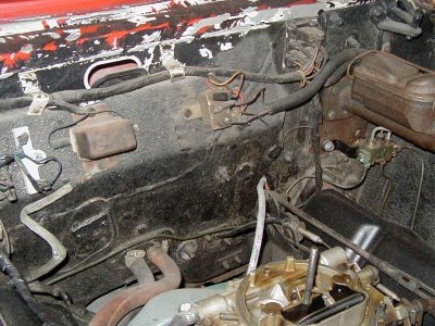

Ya, I had that thick black junk too.....

Black stuff
Mine's not quite that pebbly looking. It just looks like flat black paint, but thicker..
