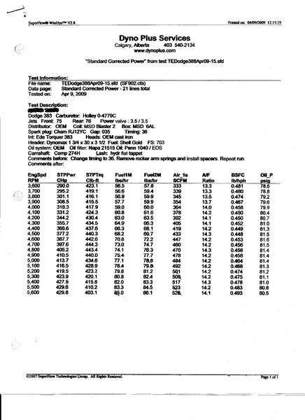

I think you did very well Rebuilding/Porting the Cast Iron Heads to see the 415 hp from the whiplash.
What kind of numbers have you seen this cam make? I didn't spend a ton of time on the heads. Definitely opened them up though. You also have to consider these are old pistons with well over 100,000 miles. Just a ball hone and new cast rings. It could've used some new bronze guides too. These were probably on the edge of factory tolerances. Too loose for a real performance engine. I could've spent a grand on the bottom end, resized rods, arp bolts, balanced, with some cheap cast Pistons a point higher in compression, 8.5 and made 1 hp per cubic inch and close to 500 ft lbs. Kinda wish I had. But it's good enough for now.

.030" over 383 Engine
stock cast low compression Pistons/Block Milling @ 9.0:1
Stock Rods
Rebuilt/Ported Cast Iron 906 Heads, 2.08/1.74
Adjustable Rocker Arms
Torker 383 Intake and Holley 4779 Carb
CompCams XE274H
430 HP / 444 Ft/Lbs Torque

Not a bad little 383!

One thing I find really great is the fact your engine is putting out 440 magnum numbers at 4,300 rpm.
Even with the low compression the cam and port work on iron heads really shows up.
Add in the fact you can buy fuel anyplace for it.
Thanks for sharing that dyno and specs.

Yeah, it runs great on 87! It really does pull in the midrange.
