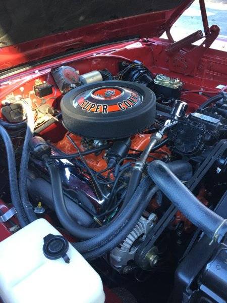

The Demonstrator has the original Chrysler Air Temp system converted to 134, after being restored with NOS parts, still has the original high pressure hose with correct date code on the fitting. Blew ice cold on the way home from Carlisle, on the lowest setting, in 95 degree heat. System hasn't been charged since last year. Condensation and frost on the lines was a real conversation starter when I popped the hood on the show field.

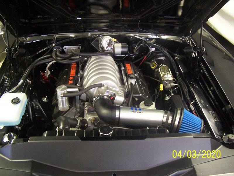

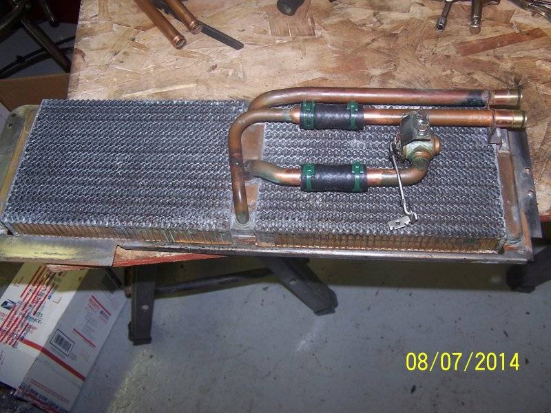

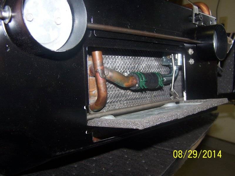

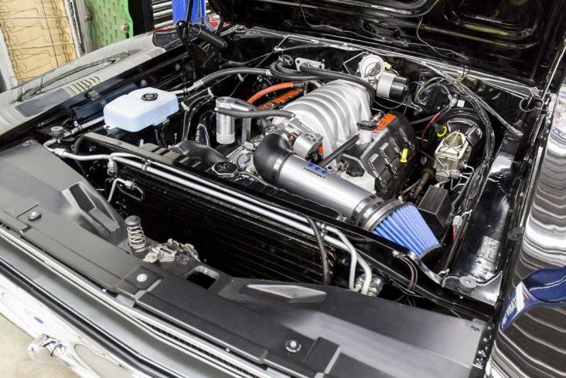

I rebuilt the factory AC heater box and controller. Had the evaporator pressure tested and replaced the heater valve and water valve in my 68 Charger back in 2014-15 when I upgraded the engine to a 6.1 from a 2006 SRT8. I am using the compressor from the SRT8 and 134 freon. Other than that, I installed a new dryer, expansion valve and condenser & had new plumbing fabricated under the hood. My AC has worked perfectly since then with no leaks or issues. Hope I didn't just jinx myself but nine trouble free seasons ain't too bad IMO.

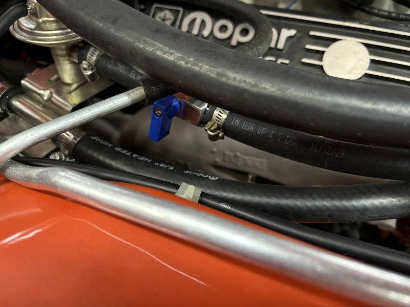

Any chance you can share a link or valve ordering info? I like that the handle is blue. I stopped into NAPA Friday and they didn't have any.
I have three vehicles with the later series of Vintage Air systems that come with an electronic water shutoff valve. All three blow ice cold, but the one car without tinted windows has to work harder to keep the interior cool when it's 90-100 degrees outside due to the sunload on the interior from the non-tinted glass.
My GTX is getting tinted glass and Classic Auto Air with some changes to the underhood hose/pipe routing. It looks like it has the same water shutoff valve that VA uses.
I can get it for you later today. I bought it from Amazon. It’s stainless and operates really smooth.
I don’t know if this is the one @T2R9
has, but it’s one I’ve gotten at Oreillys and have used. @Kern Dog , you might want to do the same and see if it helps. I’ve never had a b body with working air, but I’ve had a 68 dodge pickup and my 78 lil red with air that worked good
https://a.co/d/btedTxb
