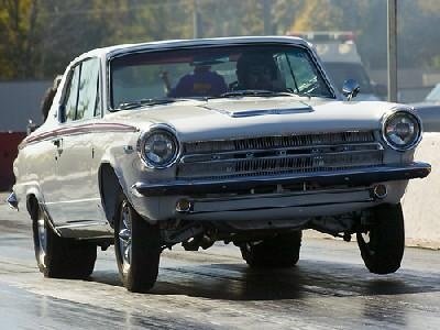

The fellow hasn't been on for a few years but he has a 410 stroker with a push button 904. Runs 11.0's through the mufflers.
