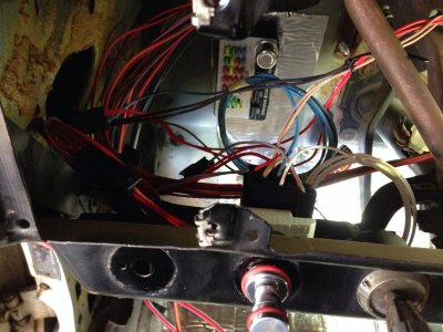

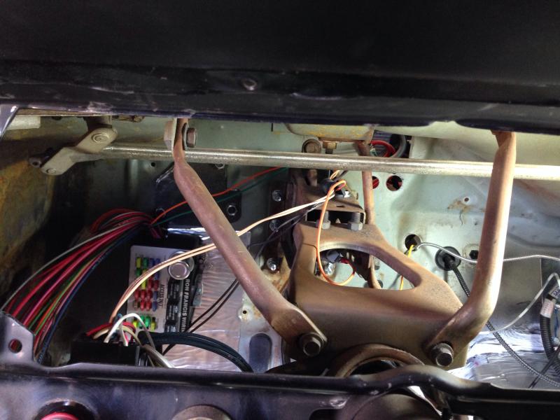

well I finished the removal of the old wiring today. I found a place to mount the new fuse panel. I started to wire some of the stuff but lost interest tonight. Hopefully tomorrow is productive

What year/model car do you have and what location did you pick for the new fuse box?
64 Polara. It's on the firewall left of the steering column
