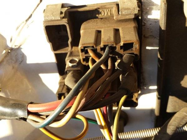

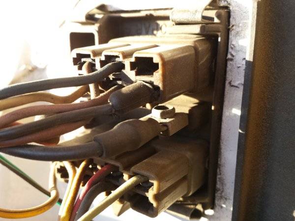

There is a big diference between the bulkhead connector in my 1962 Belvedere and my 1969 GTX. You would think Chrysler would have made improvements in parts, not downgrades. Everyone knows the issues with the black and red wire going through the bulkhead connector.
My 1962 connections for these two wires that traverse from the alt to the ammeter and back out to the starter relay utilize a bolted connection like a buss. In order to remove the connector, both little bolts have to be removed. These are as it came, no modifications.
The 1969 bulkhead connections for these two wires are straight up Packard 56 connectors which get loose and corrode.
When did Chrysler move away from the earlier connections and why?
Pics of my 1962 bulkhead connection...
