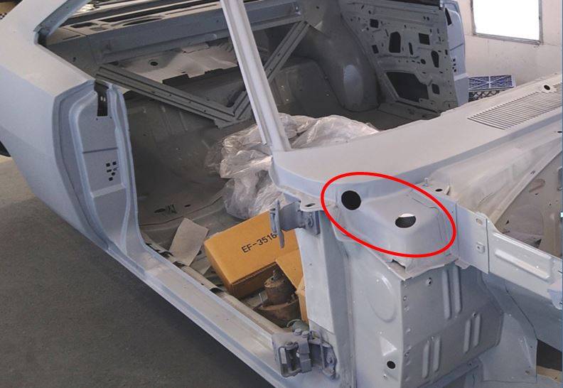

On this topic, I added a couple of large access holes (per side) for my media blaster to clean the interior of this fairly solid Charger cowl. He used an extension on his gun and was very successful. Now -- any ideas on how I go about getting a good coating of paint or sealing material into this cave??

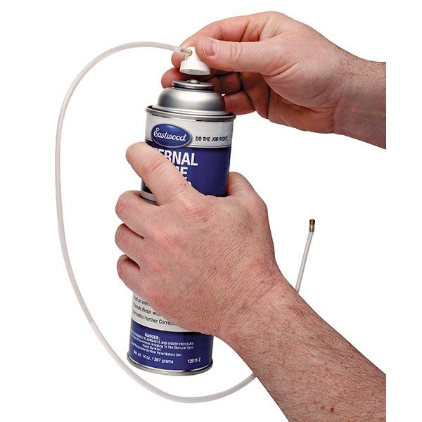

Maybe something like this from eastwood. Just have to make sure it'll fits whatever can you're using. They have some of these on amazon too but not a lot of good reviews.

I used many cans of this on my Belvedere and Coronet. Each can comes with the long tubing so, I spliced 3 tubes together and using my x-ray vision, sprayed the hell out every nook and cranny. It even creeps into flat, skin welded to skin, sheet metal. It was running out of joints everywhere!

I appreciate the ideas gents. More than one solution out there. The two cowl openings from underneath makes sense.
