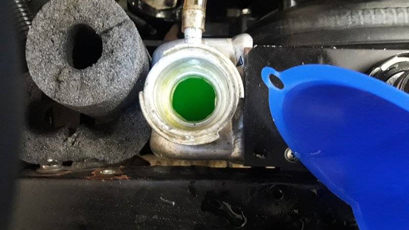

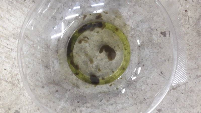

1. I took off the expansion tank. It had practically nothing in it but there were blobs of oil.
2. I put a funnel down the radiator and added fluid through it to raise the level and make it overflow. I captured the overflow in a jug. the funnel picked up some sludge on its sides as it went in.
but the contents of the jug ended up with coolant and a few tiny blobs of oil.
3. the coolant showing at the top of the radiator now looks clear.
I think I will pull the plugs anyway but, dare I say it, this looks hopeful to me so far. I wonder if, in the past, I added coolant through a funnel that had not been cleaned out of oil? But this is blackish oil - not fresh looking, isn't it.

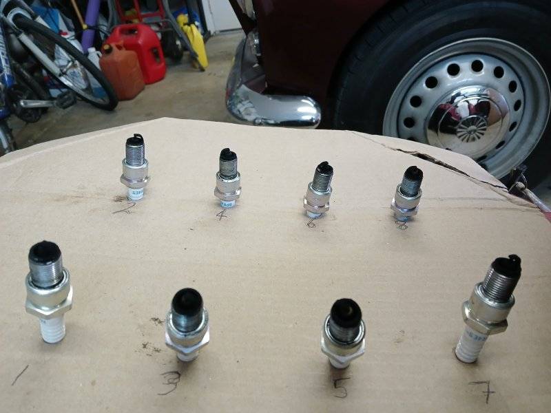

Plugs out and compression tested.
I think (at least I hope) I cried wolf. If so, my apologies but gratitude for all the advice and support.
Compression test results
Left bank : 1 - 130, 3 - 120, 5 - 120, 7 - 115
Right bank : 2 - 130, 4 - 120, 6 - 130, 8 - 120
So, no milky, yoghurty stuff showing anywhere, no oil showing now in coolant, plugs all equally fouled (see pics below. I need to fix that overfueling) and compression shows no obvious problem except #7 being on the low side.
What do you think, please?
