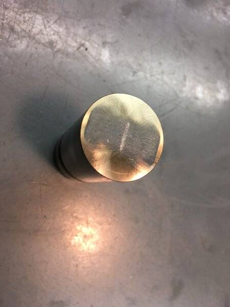

Be interesting to see if you have other lifters that have visible wear on the bottoms.
If it’s only the one lobe/lifter, I’d say it’s less likely an oil issue.
Multiple lifters going away?
I’d be suspicious of the oil.
The rest look fine.
In 32 years of working in this field, I have come across the situation where the lifter wasn’t turning, and it didn’t wipe out the cam........ twice.
They were both mild hyd profiles that were running modest spring loads.
They were discovered as part of the cam swap process, with no prior indications that there was anything wrong.
Both had been run for a couple of seasons.
Usually........ if the lifter stops turning....... it’s all over.
As you can see in the pic above, that lifter basically never had any rotation....... which normally results in immediate failure.
In the case of the cam that went with the lifter in the pic, it had inadequate lobe taper(.0005”), so it didn’t promote proper lifter rotation.

When you pull it apart check if there is a plug in left lifter gallery. Maybe somebody had solid lifters and put a plug in.
Would you happen to know if the lifter bores were properly broached, AND the lifters checked for proper spin when the motor was built?? Believe it or not, i always check these myself, after the shop says the block is ready to build. Sadly, it does look like you should pull it down, check everything again and clean up. If it was just one bad lifter, it will drive you crazy, but you'll be good next time. At 8000 miles, everything was most certainly broke in, but i'm wondering, did the car idle a lot, with that low oil pressure?? Maybe grooved halfs only would be a better plan?? 20-50 should'nt really be necessary on a mostly street engine anyway.... food for thought to discuss with your builder.
Very sorry to see the damage Sonny. Did you ever state where the lifters were sourced? Maybe a flat one from the factory, or maybe it just wasn't spinning.
When I built my motor I checked every one for a dome and matched them to bores and checked for rotation.
Comp cams.
This is one reason oil samples are good to work with. If a person changes his only every 8 thousand it will tell you of a problem or give you heads up to start looking at. Sonny if that was a bearing I would say it had zero rotation the lifter was stuck and the cam burned thru it. Having oil pressure like you do tells me not to idle it very long. You need to look at other things as you put it back together. As above has mentioned but again send in a oil sample from a new quart of oil to make sure that the additives are in there. Then take oil sample after 8, 000 miles and compare. Oil samples will tell the story.
