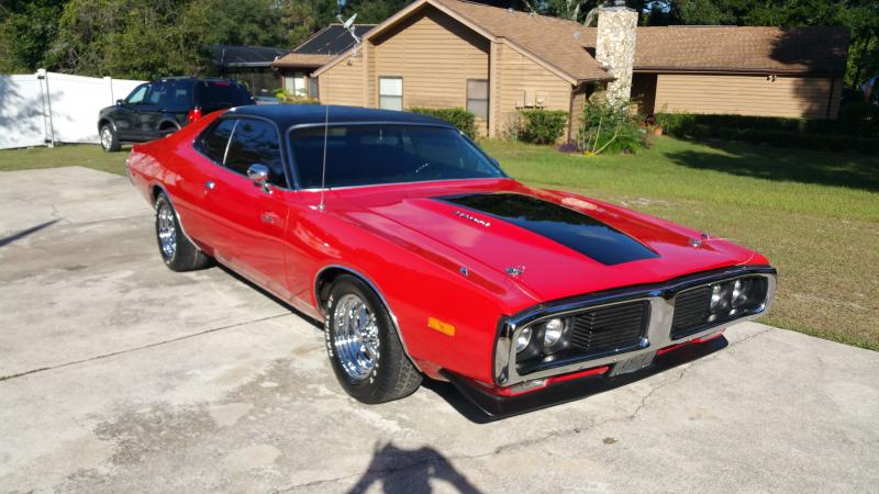

Hello all, new member here, I just bought my brothers 74 Charger Rallye, and the tires are dry rotted from sitting for 20 years so looking to replace them asap. The wheels are Keystone Classics 15". The tires on it now are 255/60 15, I am wanting a wider tire but I like the same size on all corners look. I know 275/60 15 will clear the rear but anyone have these on the front? When I turn the wheel all the way in both directions and look at clearance underneath it looks like I have plenty of room there. Any thoughts?Thanks

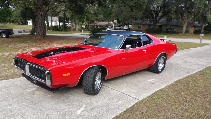

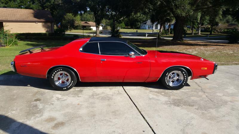

Well looks like the 275 60 15 mounted on 15 x 8 cragars will work. I got them mounted and though pretty close there is no rubbing. 20151120_145252.jpg
Wow that's a big front tire

In my option the tire is too tall, Too much lean in a tight turns at higher speeds. Side wall do not provide for strong support. 245/60 are the best overall size for look and mountain roads. Keep in mind your charger weights 4500 pounds
If those tires aren't rubbing anything, you ain't driving it hard enough :grin: And welcome to the site!
