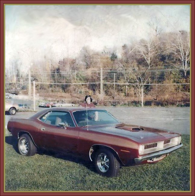

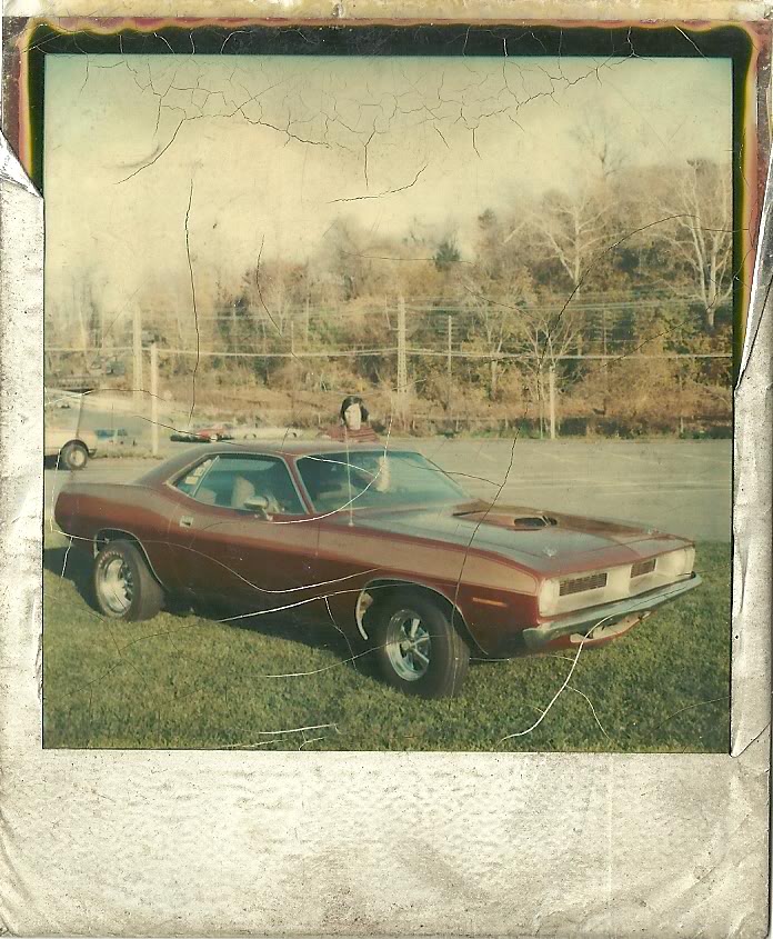

I only raced cragar ss wheels in the 70's and 80's. Fastest was a 10.38 with them for years in a 65 chevelle ss.
Previous to the chevelle was a duster going 11.95 and a 440-6 70 cuda going 12.10 all using cragars ss with no issues. You will have no problem but they are heavier than the wheels out there now.

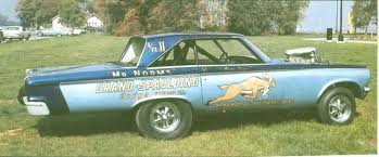

Like the air shocks in the rear?
After realizing why I was spinning back in 74 and had terrible 60 foots and losing on the street racing, a friend who use to let me use his lift told me to put 50/50's shocks on the rear with Lakewood traction bars.
Picked up huge on the 60 foot and got my 1st 11 second pass at National Speedway. 11.98
I say if they are good enough for this car & worked then you will be fine.. Just my opinon...
