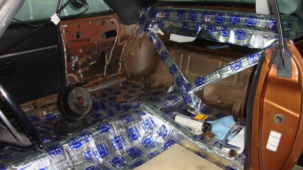

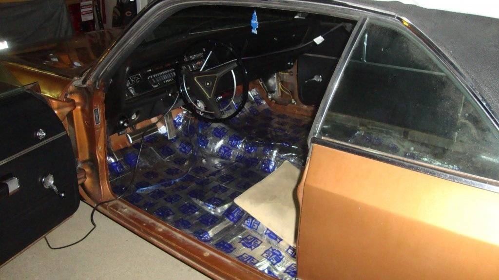

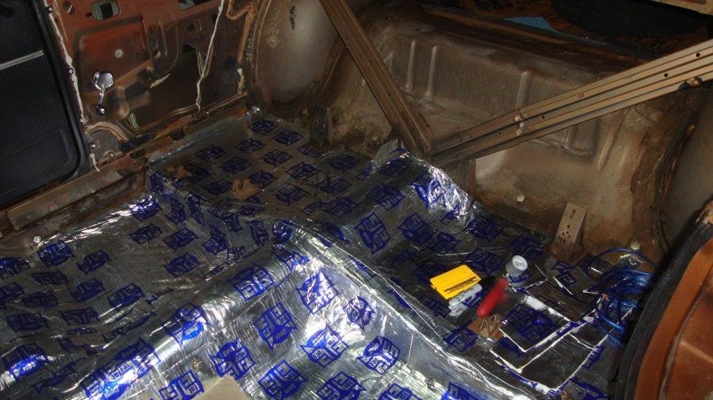

jesus man, nothing exceeds like excess...:poke:
while im over here putting a meager layer of fatmat in my Newport. lol
