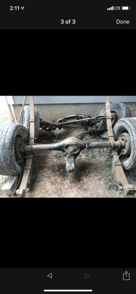

i have a ‘70 Belvedere and I want to swap the 8.25 rear (276 gear) with a 8.75 and have a 3:23 gear. I have a guy who’s selling one (742 case with same gear) from a ‘66 Belvedere 318 car. From what I’ve read the ‘66 rear is 7/8” shorter than my ‘70 8.25 rear but the perches are the same width apart. Is this correct? I anticipate having it restored with 3:23 or 3:55s. Any other pitfalls? He’s asking $200 and I pay to have it shipped from GA to FL. Good deal? Comes drums to drums (I have new drums/brakes to swap parts).

In case you want to see the case number I have pictures of that as well. As far as it being the original rearend to the car.. Your guess is as good as mine. It was in the 66 Belle I used for a parts car. It does have aftermarket traction bars on it. So there is a possibility that it has had some work on the rear end done at some point.

Since now I question whether its the original rearend now.. I will measure the rearend from backing plate to backing plate.. Ill post those numbers.
