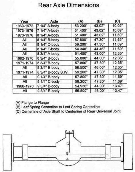

Will this 8.75 rear work?
Here's a chart:
I will go measure the rear end and see what it actually is. Maybe just has the 742 center but still the original housing..
Center to center on the spring perches 44 inches. Back of axle flange to back of axle flange is about 54. They still have the brake assemblies on so its hard to get the measurement from end to end on the flanges. What I did was measure back of flange to center of the pumpkin both ways I got 27 inches.
The u-joint could be a 7260 or a 7290. It is not a 1330, no tabs to hold u-joints in place.
I've found them to be anywhere from 3/8" to 3/4" shorter....with the 3/4" being the only one. Most were around what you mentioned to 1/2" shorter. Seems ChryCo didn't have a very tight tolerance with this stuff. Even the 68-70 rears varied a little from what's listed in the charts.
If you think about it, the tolerance couldn't be very far off or the end play adjusters couldn't compensate.
