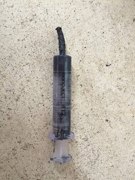

There are ways to still seal it without removing it.
I installed my back glass and had two leaks.
I went to a veterinary office and asked them for a plastic feeding syringe with a curved tip. I was able to use it to directly inject some of the bedding compound under the gasket in the approximate area where it was leaking, and it seemed to work, but because the syringe tip was plastic, it was not very precise. So I currently have on order a “adhesive applicator syringe” from amazon. It has a steel needle that I will attempt to bend and shape into the correct L shape, so as to allow me to inject the bedding compound directly underneath the gasket where leaks are. Using the plastic syringe reduced the leak, but I will not proceed until I get the steel tipped syringe in the mail. I am not sure if it will work.

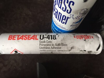

The second leak appeared to be from between the glass and the gasket. I used the stuff below to seal that part. It seems to work as well.
I suggest you try this an experiment to see if it fixes your leak.

There is moisture between the glass and the seal on the inside of the car. I think I get the picture on how to fix it. I'll give it a go when I get the sealer. Hell, it can't hurt.
