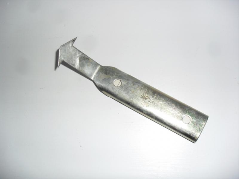

Yes there is a special tool to remove the chrome molding looks like an hour ahead that's what I used on my 67 but there is a couple different types just goggle Chrome molding removal tool you'll see what they look like
Bought this from Mac about 40 years ago and haven't worn it out yet. Mac (MR215) tool#. SAM_2760.jpg
