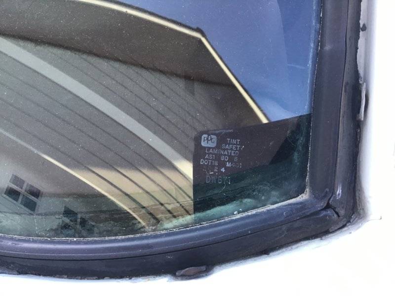

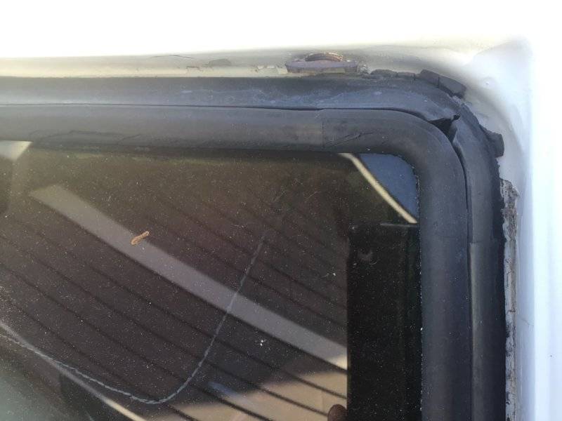

The gasket has a lock strip, they don’t unlock it in the video. I don’t know if that car has a lock strip. B-Bodies usually have a lock strip. You can see a parting line that runs parallel to the edge and has angled seams on the corners. You unlock it and fold the outer part back. You gently pry in the groove and it sill open up. The part of the seal near the body rolls back towards the body, then the part on the glass rolls back towards the body. Then you can start pushing the glass out. A helper may need to hold the lock strip out of the way.
Here are 2 photos of the lock strip on a 1967 B-body.
Ask more questions if any doubts.
