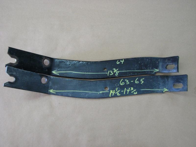

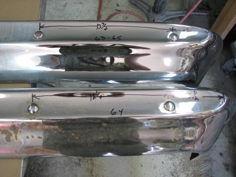

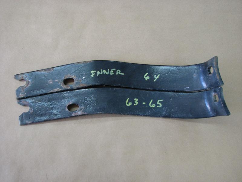

Miller: Checked out both bumpers and brackets this AM. Outer bracket is the culprit. The 64 outer is about 1" shorter than the 63 & 65. I'm going to post an informational set of pics later if I can figure out how to use the wife's camera. Mine bit the dust at the MoPar nats this year. Try to locate a set of 63-65 outer brackets. Least costly path to follow. I've been in the same pickle as you, only the reverse. My 65 had a corroded rear bumper so I bought a rechromed unit for my 65 (actually a 63) and found that the brackets were wrong. Then had to hunt out a set of 63-65 brackets. Someone had put on a bumper assy off of a 64. Probably a body shop.
